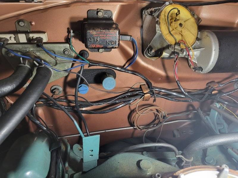

Does the vacuum hose enter the firewall with the heater hoses or somewhere else?
The vacuum line comes off the intake with the brake booster, assuming power brakes, and enters the firewall next to the water valve, below the VR and above the evap lines.
