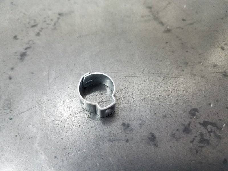

What is the correct name for these clamps?

Looking for some to use on 3/8 fuel line which is a good 5/8 od. I have checked with all the parts houses around here and nobody sells them.
IT COULD BE A CLAMP FOR PEX PIPE, TAKE YOUR SAMPLE TO A PLUMING SUPPLY NOT HOME DEPOT. JUST BECAUSE THERE ARE MANY DIFFERENT BRANDS OF PEX. LOOK IN AMAZON.COM.
TRY AMAZON LOOK AT PEX PIPE CLAMPS THERE ARE A FEW DIFFERENT TYPES, BUT YOUR DIMENSIONS SEEM TO BE FOR 1/2 INCH PEX PIPE, IF IT WAS AN AIR HOSE CLAMP, IT WOULD PROBABLY HAVE AN EAR ON BOTH SIDES AN BE MADE OF A A THINNER MATERIAL. THIS IS NOT A FACTORY CLAMP, IS IT?

AS FAR AS I KNOW ITS A 1/2 INCH STAINLESS PEX PIPE CLAMP, THERE IS A SET OF SPEC PLIERS FOR DOING THE CRIMP, THAT ARE ROUND WERE THEY TOUCH THE SURFACE OF THE CLAMP SO AS NOT TO CUT THRU THE CLAMP LIKE YOU WOULD IF YOU USED DYKES. I GOT THE PLIERS AN A FEW CLAMPS FOR LESS THAN 20 BUCKS I BELIEVE, MADE IN CHINA OUT OF NOROVIRUS AN CHINESEIUM.
THE CLAMPS ARE 12 BUCKS FOR 50, YOU CAN GET THE CLAMPS, AND THE TOOL FOR 24 BUCKS, WITH AN ASSORTMENT OF CLAMPS 3/8 TO 1 INCH.

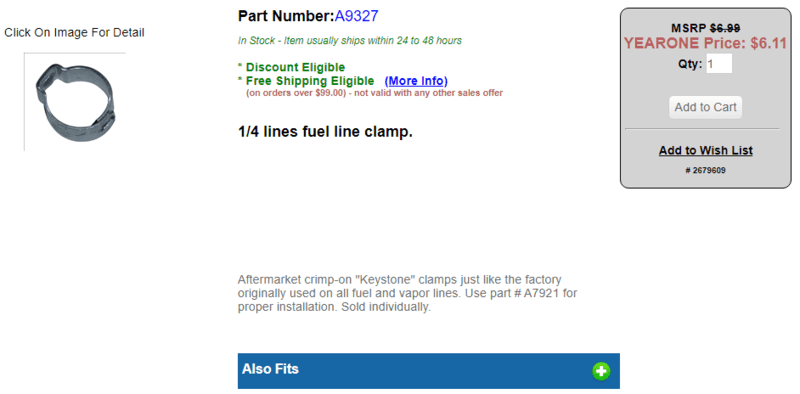

YearOne Inc calls them "Keystone clamps", and they work very well. I bought a bunch of them years ago plus the crimping tool.
Typical Year One price gouging. $6 bucks a piece for that clamp? I think NOT! And then they probably want another $20 bucks to ship it.
