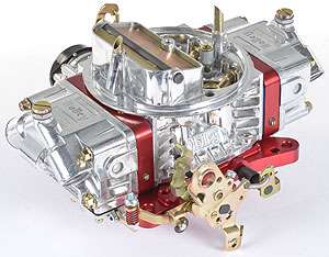

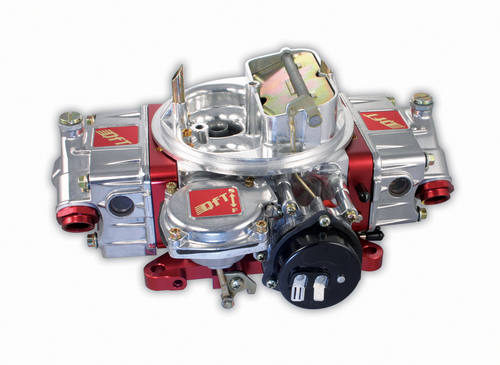

Personally I prefer the Holley dual feed 4150 or 4165 style carburetors... for a 383ci a 700cfm-750cfm DP or 770cfm Street Avenger w/Vacuum secondary & electric choke... Formula basically 2cfm/per Cubic Inch is a good basic guideline, or try this formula; Cubic Inches (X) times RPM ('/.) divided by 3456 = Total CFM... Or if you want a really good performing carburetor, spend a little more money & go to my 1st choice a Quickfuel Tech. or Promax or Proform type carburetor, or many other great aftermarket Mfgrs., of the Holley style platform DP or Vacuum secondaries, dual feed, center pivot float, performance style 4bbl carburetors, they are even better & even way more tunable than even the std. type Holley's HP DP 4150/4165 carburetors...
Add a good quality "cleanable" type fuel filter, before the Carburetor & a drop base style K&N X-treem air-cleaner/filter combo, for much better filtering & flow, then your all set...
