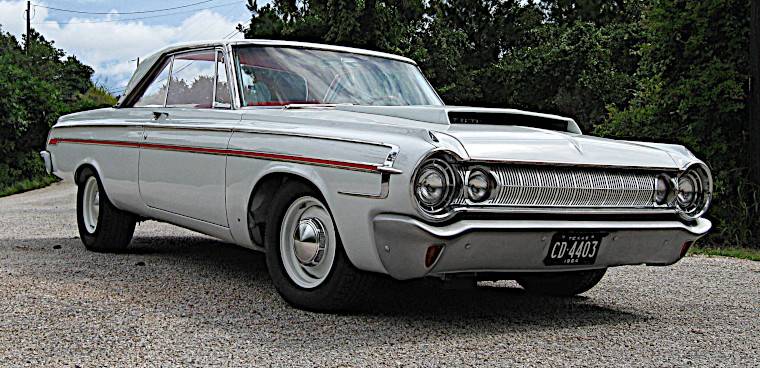

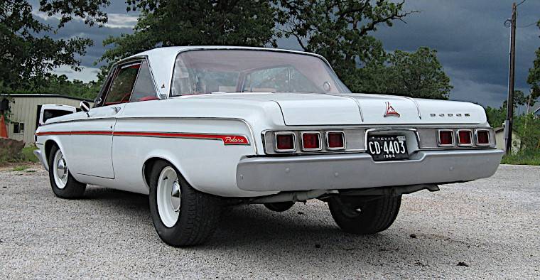

I have a pair of 16x8 1/2 torque thrust with 4 3/4 bs with 10x28 slicks that fit great on my 62. Using 15x7 with 235/75x15 on the front, but the splash pan is cut back a couple inches for tire clearance for the height. They also rub on the header tube in the wheelwell.

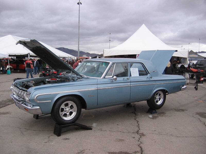

Not a problem on my 'ol 64. 16x8 all round. I did not run wide tires.Maybe 225x65x16 sound about right.
Hard to tell they aren't 15's
Those look great on your car! The 16’s seem to fit the car nice IMO…not too much not too little. Yeah, was thinking if I’d get 16’s would drop from the 60 to the 65 tire size. Read somewhere this reduces the overall diameter by around ½”.
