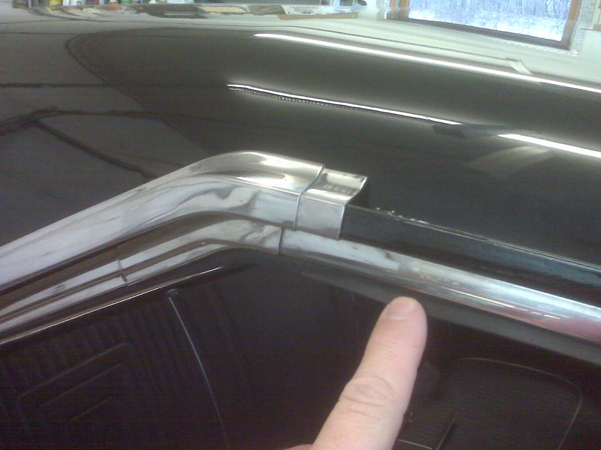

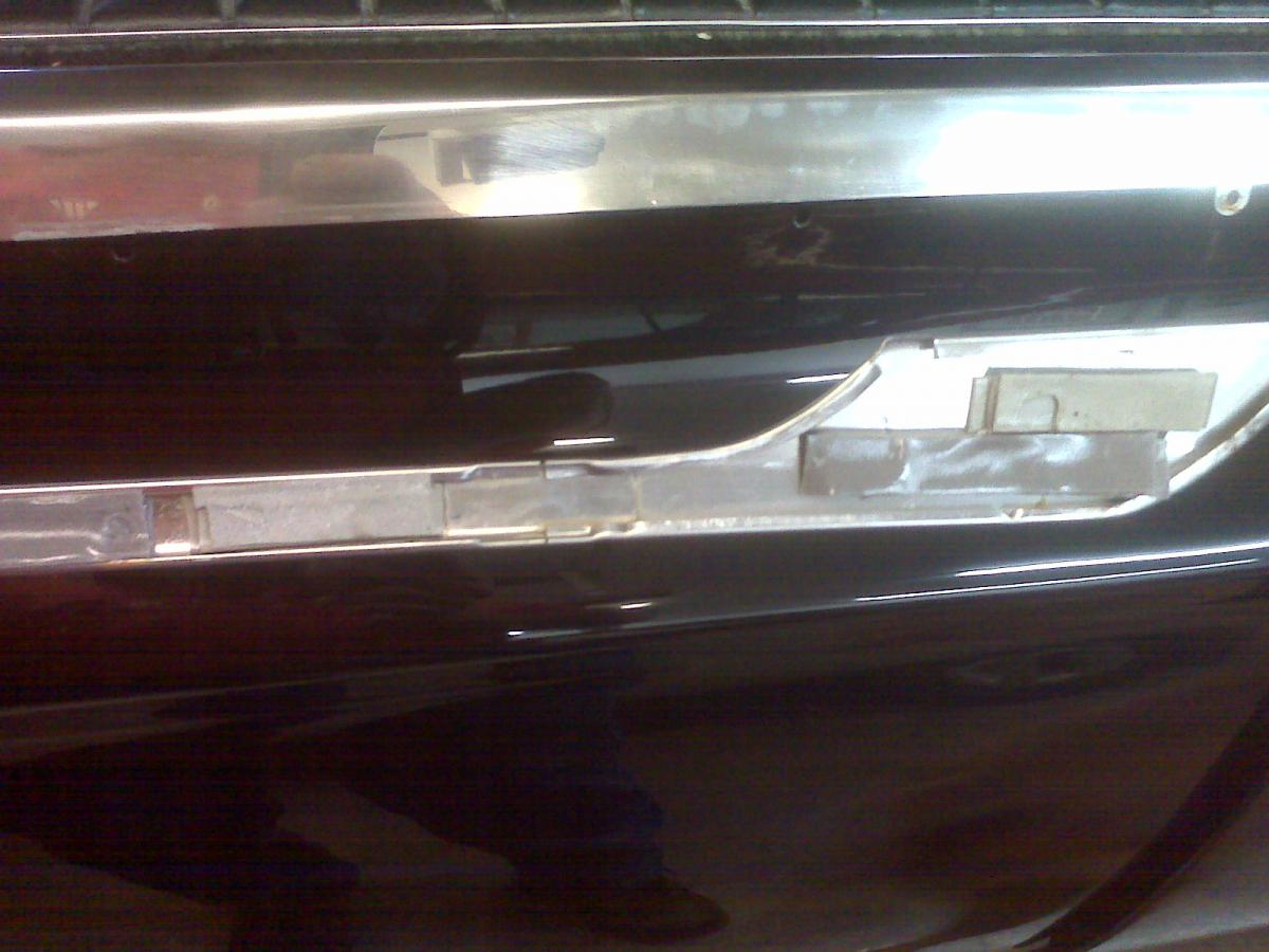

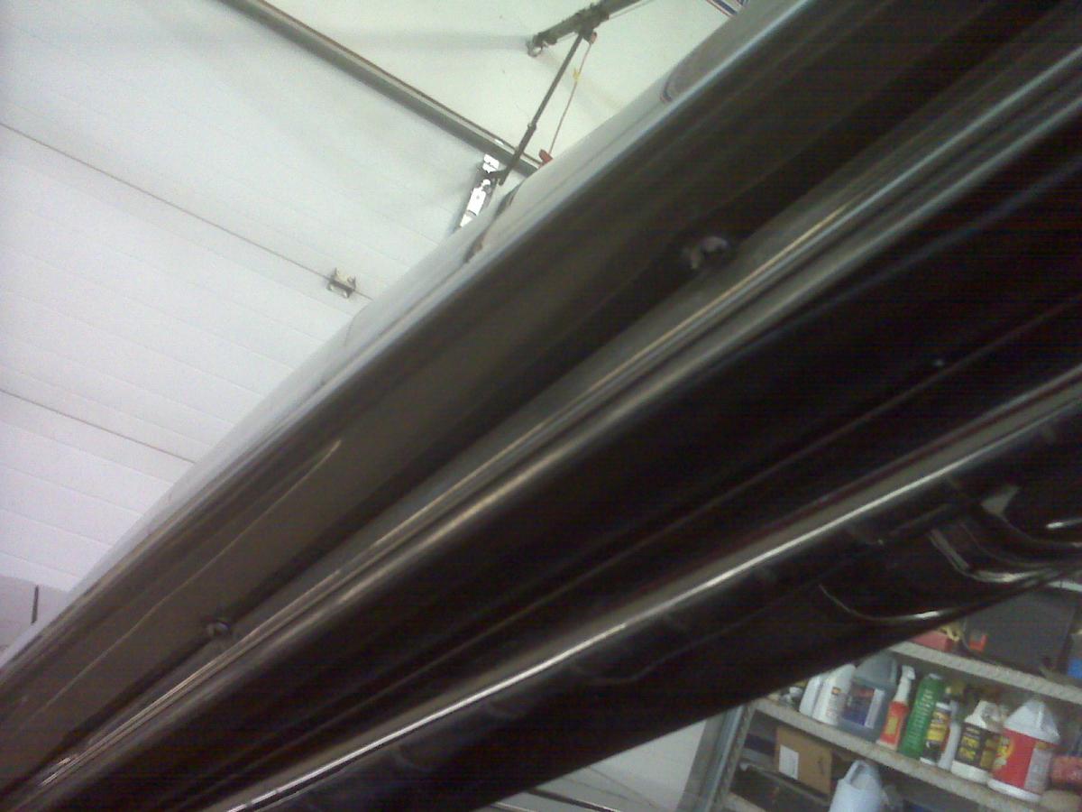

Well my moldings on top of the door dont even have any clips to refernce to, they were double sided taped on. Can any one assit me in finding the correct clips and how do you remove the molding around the door window. I was working in it late last night and it was kicking mu butt. Also I am having trouble removeing the trim at the bottom rear side glass. The door just came off easy after removing the screws but the back one still seems attached. I see the screws holding the top moldings but the glass trim is preventing access to those screws. How do you remove that????
clips
the seal pulls out of the channel. the channel has screws in it .the clip where the double side tape was at, is made of metal, i need one to. where to find them i don,t know. the use ones are to far gone, rusted away. the back roof trim that go,s down the rear pillar has three screws , you can see them from the outside. at the bottom of the trim piece there is a stud with a nut on it. you to get it from the in side, its behind the sail panel, where your interior light is. be careful, that clip is hard to find to.
