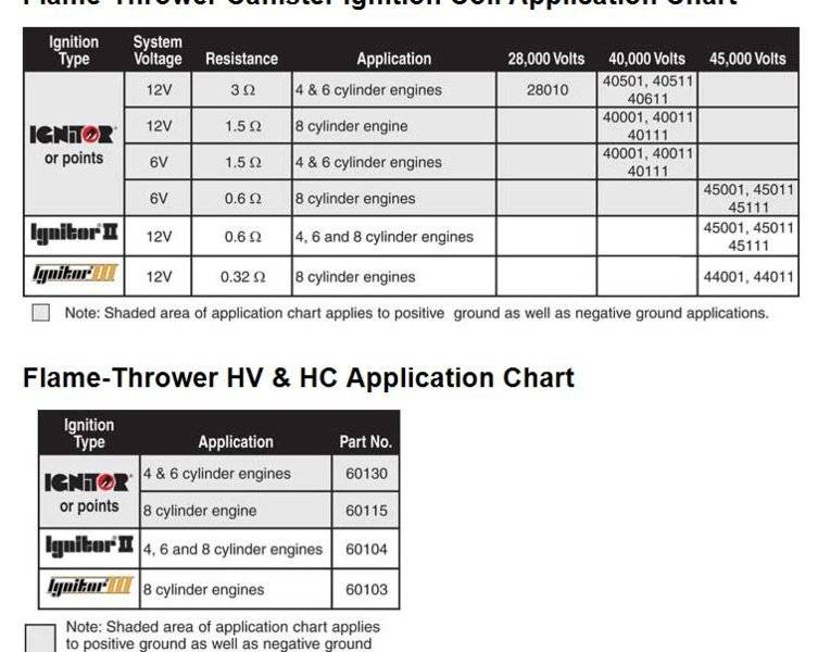

I've looking at Pertronix e-core coil 60130, 60103 or 60104. As Koosh is asking how do choose which coil to buy. First I listed 3.0 ohms 2nd is 0.32 ohms 3rd is 0.45 ohms. I know ohms is resistance but how it effect what coil to choose. Thanks for asking koosh I had the same question.
No prob.....finally found a write up on the web, regarding the Flamethrowers, the 1.5 ohm is best for v-8's, and the 3 ohm works with the Pertronix Ignitor ignition system.....prob not much help for yoir e-core question though....

Note system voltage, does 6v or 12v mean at coil? The lower chart are e-core coils believe they get 12v at the coil, no resistor.

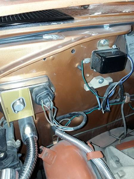

So I purchased the Flame thrower 40001, 1.5 ohm.....still need to know if I'm suppose to remove ballast resistor? If so, where do those wires go?
Thanks
I should add I have Mopar electronic dist., and this ballast resistor....
Note system voltage, does 6v or 12v mean at coil? The lower chart are e-core coils believe they get 12v at the coil, no resistor.View attachment 678021
@Fran Blacker , i think that chart refers to the older six volt systems. I've got four cars that use a six volt system, i didn't know that there was anything electronic available for them Thanks for this!
It refers to both 6v and 12v, the charts came from Pertronix website.
Just join the ballast wires together icy end up not needing it. Kim
Just match the colors on the 4 wires and connect them?
Does this do anything to other components?
