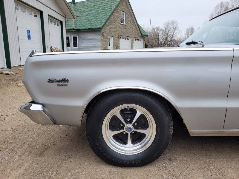

Thanks Scott.. I missed FRONT! I'm running 225-70R15's on the front on 7's without issue.

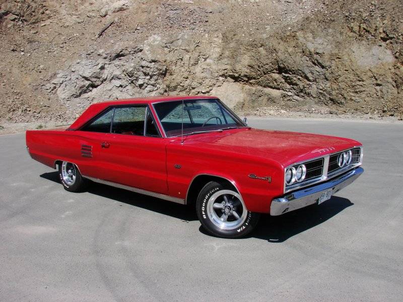

235X60X15 on my Dodge, I don't recall the backspace though (just off the shelf 15X7 American Racing Torq Thrusts). No rub. I've never compared the Dodge to Plymouth though.
