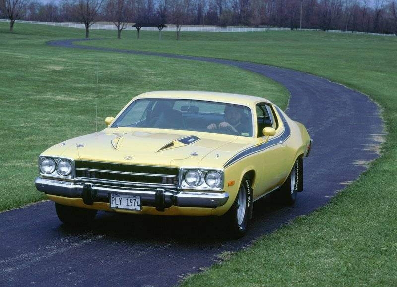

We have a 73 roadrunner, and a second hood off a 74. 73 has hood vents and the 74 has none. Our 73 has 3 point seat belt harness, I thought all cars did in 73? Hard to see the hood vents in any of the pictures posted. Bumper guards would be a better way. I think the 74 plasticbumper guards look like the pictures posted, so I am going to say that car was a 74...

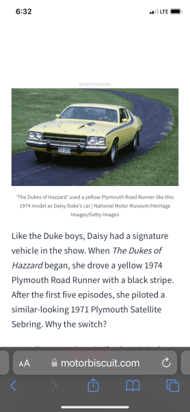

Post #7 looks like no hood vents and all rubber 74 bumper guards.
I’m always trying to figure out the years of the vehicles when I see them. And this one stumped me. From the outside the ‘73/‘74 RRs are very hard for me to differentiate on TV.
That article helps make more sense of what everyone is saying here.
Thanks @YY1 for hashing this out with me.
@DeltaV thanks for sharing that article. Good read.

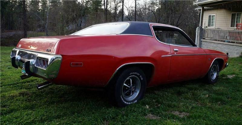

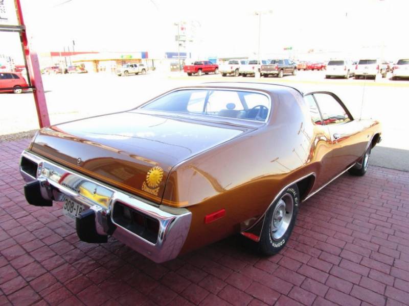

The bumper guards are the same for both years it’s just whether they were standard bumper guards(solid rubber) or deluxe guards which were chrome with smaller cushions..
As stated the hoods are different and seat belts.
The dash bezels are different, the lower rear interior panels are different, the trunk floors are different and the steering columns are different.
Also in 1974 they used T handle slapstick’s & Ball mounted shifters like the 70 e bodies..

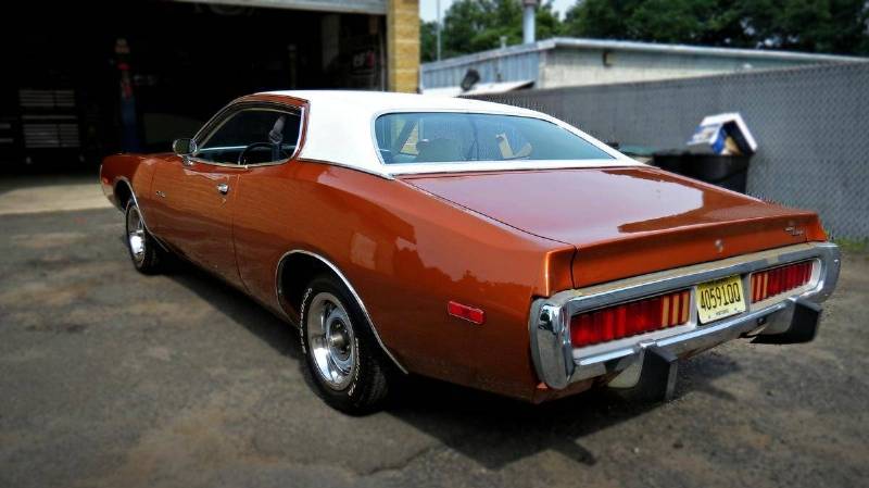

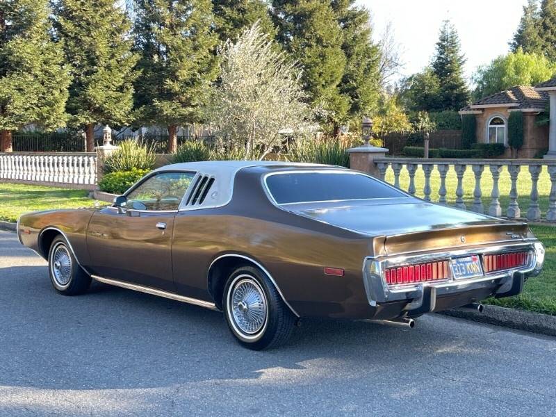

about bumper guards… dunno on Plymouths but on Chargers both years got full rubber (standard) and chromed (DeLuxe) setups, but the diff is the length, more noticeable on rears… on either setups. 74s got way longer guards. I have no reasons to think Plymouths were diff.
About bumper guards, there is another difference. 73s uses an straight brace to attach to an extra “offset” bracket attached to frame rail, while 74s got a curved brace which meets the frame rail and frame rail gets provisions for U nuts.
Here is the diff (on Chargers) about the guards lenghts between 73 and 74s. Using same example (DeLuxe) for the comparison, but standards are the same
I guess Plymouths should be the same
Plymouths are the same about guards
73
74
the length diference is the same for standard (full rubber) guards, just not posting the pics to fill the thread with unnecessary pics once diff has been stated.

first Five episodes used a '74 road runner, then a '71 Sattelite Sebring until the Jeep was brought in.
