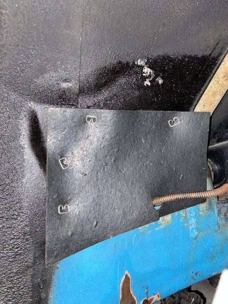

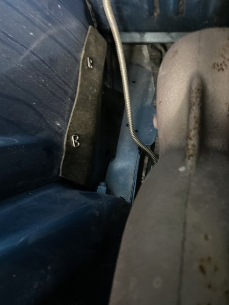

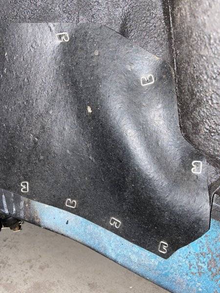

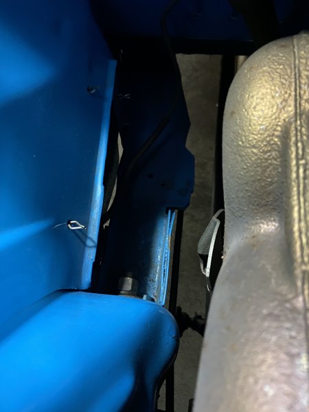

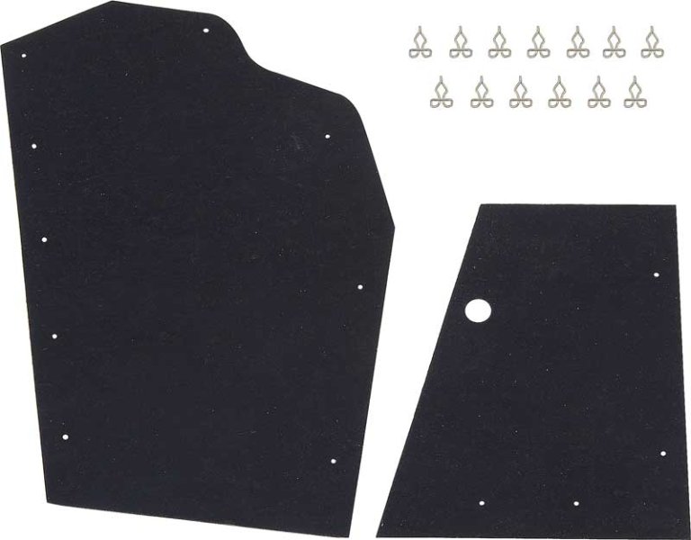

Can someone please tell me where these go? Picture would be great. MB184600.jpg
The larger one goes on the drivers side. Install from inside the fender
On the 68 B Body they install from the outside.i could be wrong though. My 70 has it on the inside on th passenger side. Very good question.
Outside drivers side, passenger side has been know to be on either side. My '66 is inside, as well as '69 and '70.
Drivers side can only go on the outside! Holes in the frame to install the push clips into. Passenger side rail doesn't have any frame rail holes, as it goes inside..
Thanks for all the pictures and help. I will have questions still when I get more time. Thanks again.
