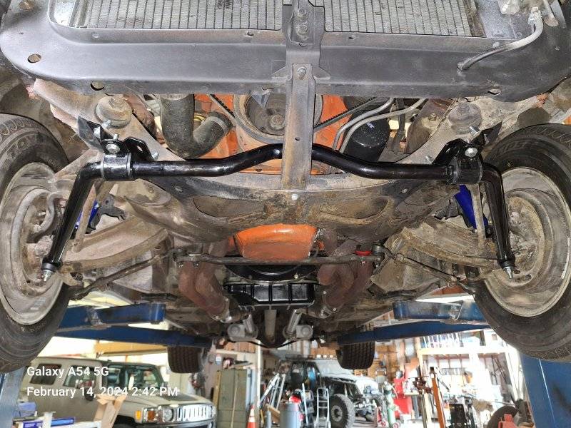

I just installed front and rear sway bars from Summit. Once the front bar is in place the tabs can be welded. Maybe drive it a bit to see where the tabs want to seat. If helps I can send a better photo of the tabs on Monday.
Can they be welded on with the lower control arm installed on the car?
Looks good, which front sway bar from summit is that?
It is the 1.125
ACO-K1-541-0U
Sway Bar, Black, Steel, Front, 1 1/8 in. Diameter, Dodge, Plymouth, Kit
(Mfr. #: 541)​

I have a set of mount tabs that will work $100 with hardware.
Also have a rear sway bar.
If end up swapping out the lower control arms I would suggest putting in heavier torsion bars at that time.
You can also just weld on tabs to your existing lower control arms.
