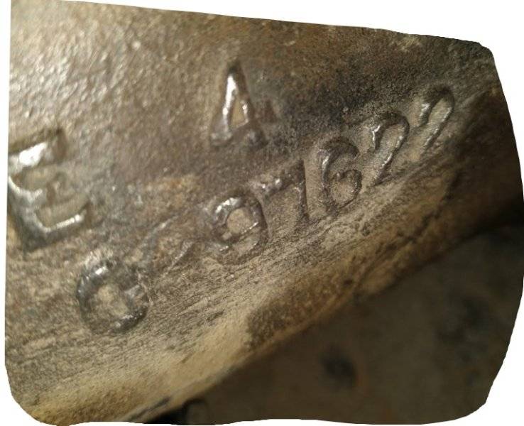

There are 18 spline and 23 spline transmissions. You will pay a lot more for an 18 spline, but 23 is all you need for a stockish 383. You want a B body or E body trans for the correct tailshaft length. A 70 up trans uses the automatic crossmember. A 66 up trans with the slip yoke would make things easier, as you can use your drive shaft.
This video might help. I'm not sure it's 100% correct but you'll get an idea what to look for. Get one with b or b/e tailhousing, non ball trunion, non overdrive unless you want that. They're supposedly weaker and came later on.
18 spline is designed for the hemi. The input shaft is bigger diameter.
23 spline is for the rest and input shaft is a little smaller. Still an excellent tranny. Will be all you need for your 383. Much more affordable.
