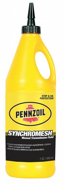

Not a Pennzoil fan but this stuff does work well.
Read the label before buying! It has been a few years since I bought any. Back then there wasn't any ATF based lube. Thanks for the clarification.

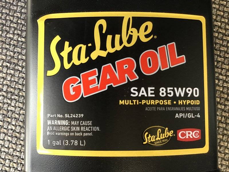

Brewers says use this sta-lube SL-24239.
Brewers is a vendor that specializes in mopar 4 speeds.

I buy Sta-Lube GL4 transmission lube at NAPA in my area.
