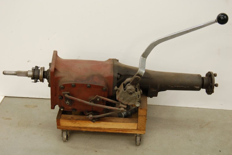

What I need is a side picture of shifter mounting spot, I have a 69 trans with 2 different tail housings I want to use in a 65 Belvedere. Looking for the 11” bell also but I’ll put that listing in the wanted section
Thanks
You need to use the forward mounting location. The one closest to the speedometer cable.
Forgot to add, trans mounting pad location also
Mine:
This is the transmission out of my 1965 Coronet 500. It was a factory 426 four speed combo. I pulled this transmission out back in the 90's and it sat in a corner of my shop for years and years. Finally a guy offered me $500 for it so I sold it. I didn't want to sell it since I knew that if I ever needed one I wouldn't be able to find a complete unit with the shifter, but I hadn't used it in 30 years so why keep it?
Thank you, that shows everything I need to know. Even thought it’s a console type it shows Trans mount location and shifter arms layout. The only difference is I’ll use a slip joint instead of trunion
