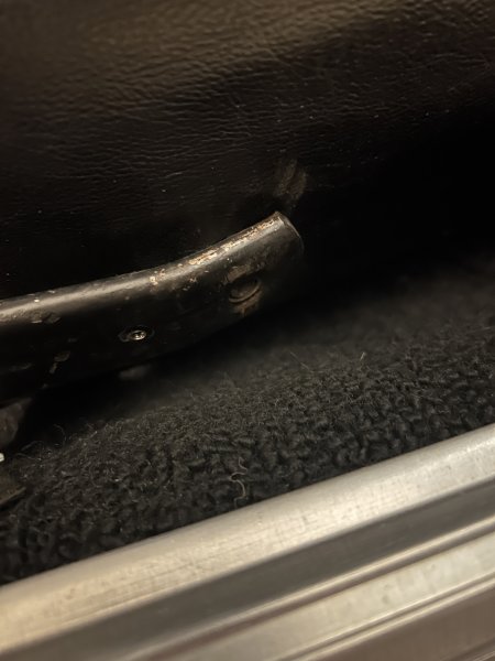

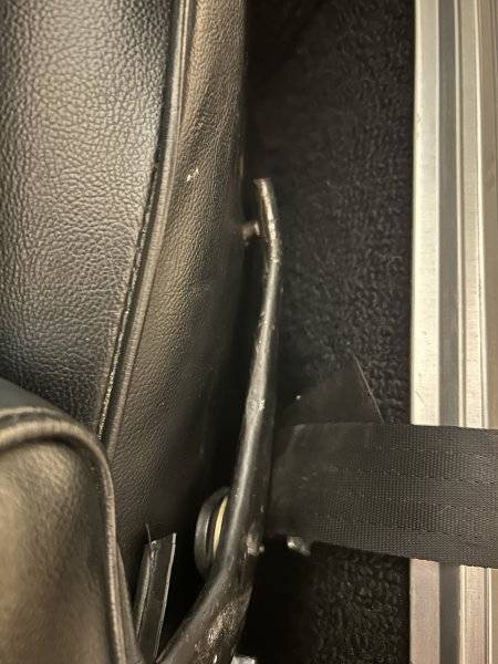

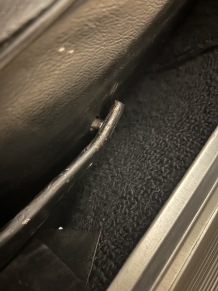

My 69 Bee’s front bench seat has an issue and I’m curious what is correct. When tilting either front side forward, the back cushion easily comes out of the side pivot post.
Is there suppose to be a cotter pin or something to hold it in place? Or is my lower arm bent out of alignment, because I’d have to really pound that arm in to get the post sticking out enough for a pin. But the pivot post on the driver side sticks out a little bit more than passenger side. Plus, my pivot posts don’t even have holes drilled, so I’d have to do that.
Looking at my 69 Parts Catalog seat diagram, I can’t make out any cotter pins being used. Nor does the FSM mention or show securing pins.
Now I’m wondering if the person who “restored” my Bee f’d up the seat back assembly and something’s out of whack.

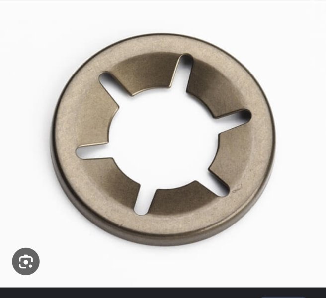

A flat washer type clip with teeth around the inside grab the post. It pushes on over the top of the seat back arm. No cotter pin.
Like this? But I’m guessing the seat arm is out of alignment since the pivot post doesn’t stick through enough to get that washer on.

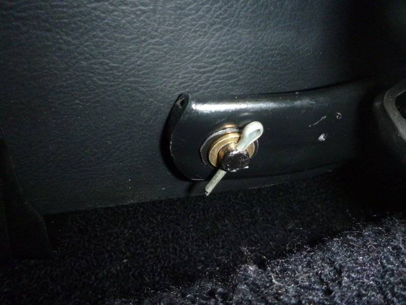

Mine had holes when I tore it apart for restoration 2016 to 2019. Possible that I may have drilled them back in the '80's when I changed the carpet, or possibly the guy that recovered the seat in '88. Works real nice..

I need to tear into my seat and see if something is wrong. Your arm looks much closer to the bottom cushion than mine. Need to see if I can push the pivot stud out further because at this point I probably can’t even get a push washer on.
