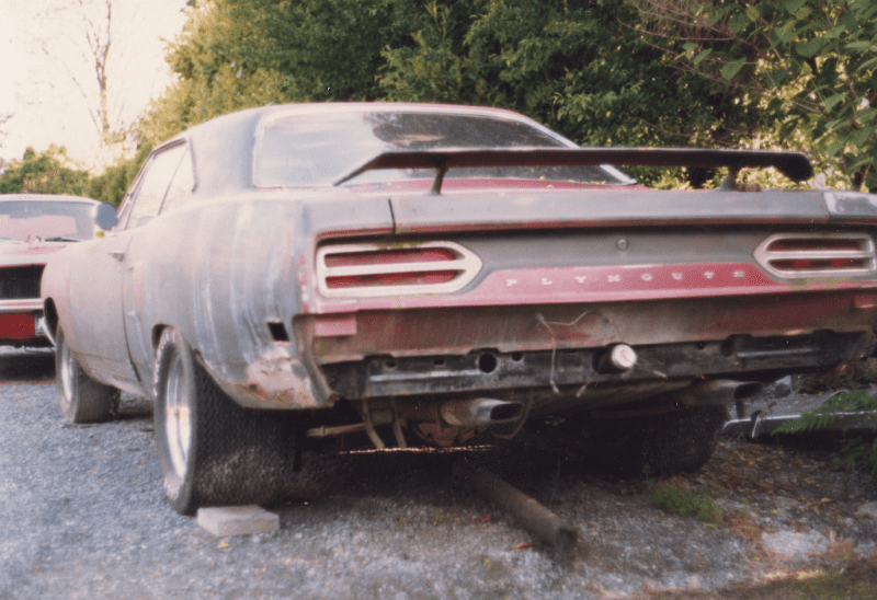

I had N50 Formula One super stock tires over forty years ago on my 1970, as shown here with all the original rust attached. With a 12 1/4" tread they were slightly wider than a 295. They fit the original quarters but after replacing with new panels that had slightly deeper wheel lips they no longer cleared. Those are on 15 X 10 Appliance wheels. Although they didn't originally rub the wheel lip, on hard cornering they started to polish the inner frame rail just a bit.

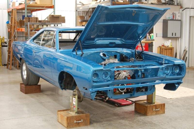

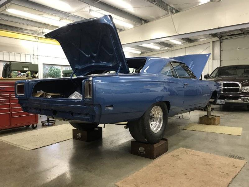

What I DO know is that a 10.5 x28 slick fits well on my 69 runner, on a 15x8 1/2 centerline with a 4 7/8 backspace. My car does have the lip rolled, and a 10.5x28 slick is almost the exact same as a 295/55x15 drag radial.
So you basically want to run the same tire I have, a bit taller, but with it an inch and a half closer to the fender.
