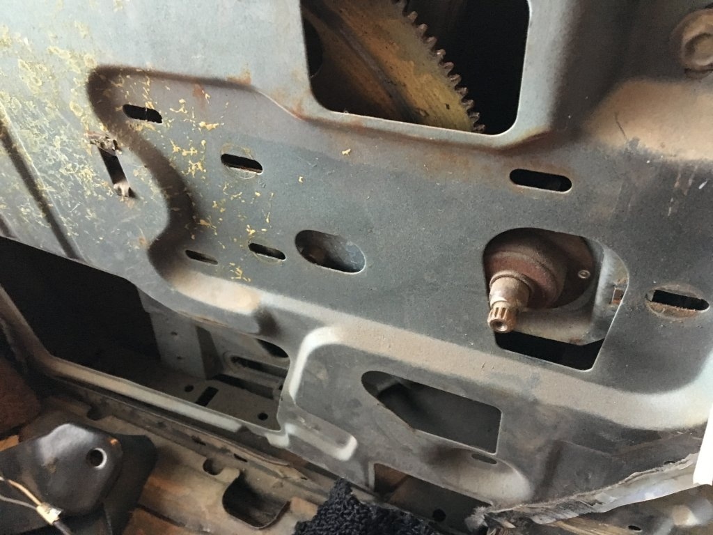

Pressing those rollers on the long track "followers" is tricky. (Yellow notes in first picture)
I had to break the old ones off and then back the assembly up at the swivel point to press the new ones one.

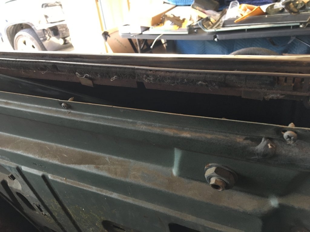

Regarding the fuzzies, do you install them prior to putting the glass window in the hole then?
To be able to get a screw driver on them?

No I drop the rear window limit stop in the lower corners and the window drops down far enough to access. Same for 66-67 chargers and 68-70 by the way.
Also be careful once the fuzzies are in. They want to catch on the chrome frame that is on the quarter window. Right where the fuzzy ends at the door pillar. What I do is file them lightly. When you take them out of the package, especially top cat, they are sharp from being machine cut. I bend them back very slightly away from the window frame direction and then file lightly.
Don't use any power tools to file it because it will catch the tiny little metal strip in gack it up....trust me I hammered a set doing that

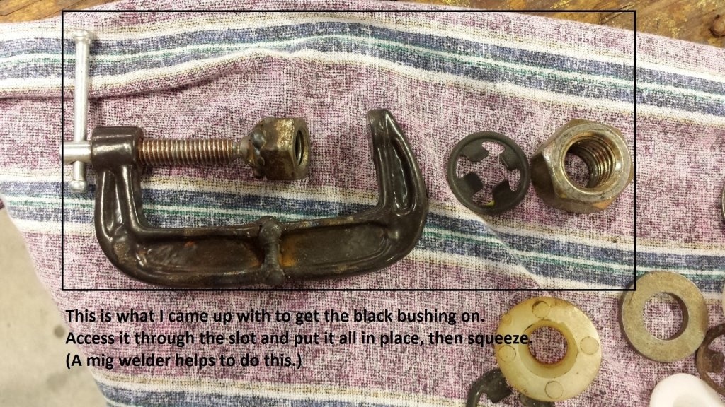

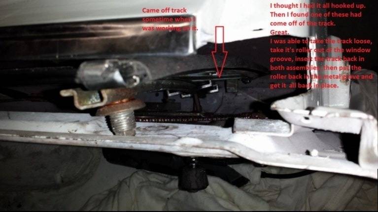

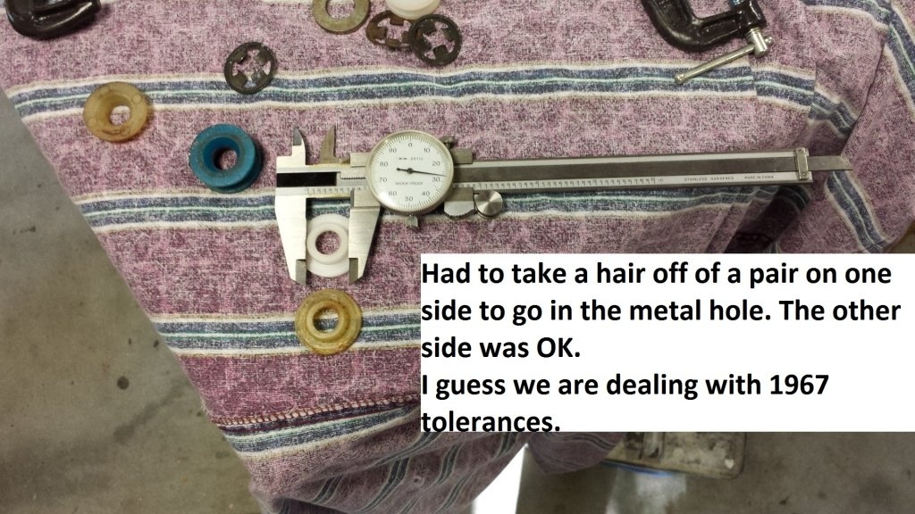

I spent all day on that one troublesome clip on the drivers side. (RED)
I had all the other bushings in and then moved the regulator and things came apart and I had to redo stuff.
At first I could only get two of the four ears on the clip to lock.
I had to take more off of the two piece bushing's width and try different "adapters" on my clamp.
I finally bent the 4 ears on the clip toward the recess in the roller to get them all locked.
(There is a recess on the regulator stud bushings. You can see it in the pictures above.)
I was about to give up and use and "E" clip.
I finally used a little piece of stainless tubing that fit in the nut to push the ears into the stud's grove.
The ID of the metal tubing was that same as the OD of the stud.
Chrysler must have had a pneumatic tool with a precision fitting face to do this on a production line.
To just push on the clip's ears some way.
That's all I can figure.
That "wobble" roller is not to hard because the stud length lets you get it started on one ear and work it over the stud.
The wobble roller stud is longer than the regulator studs.

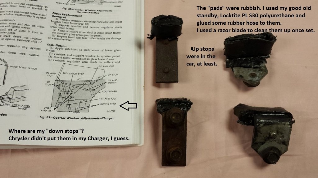

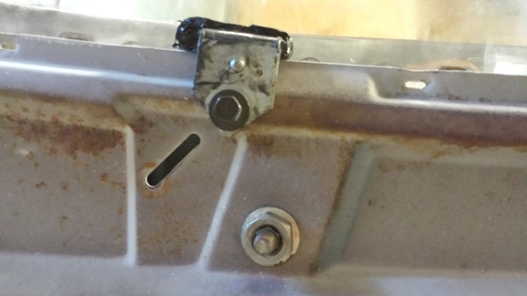

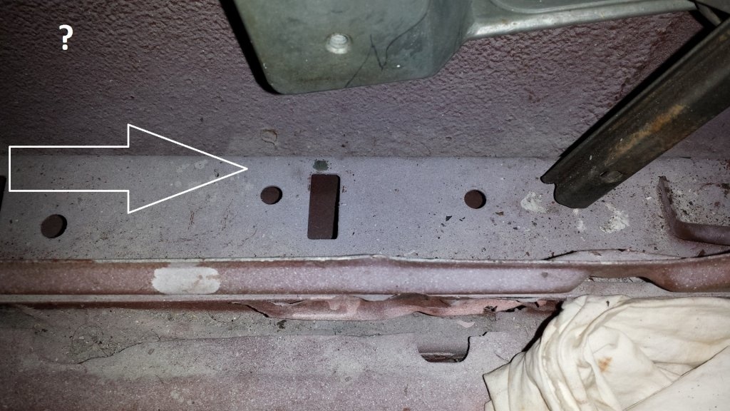

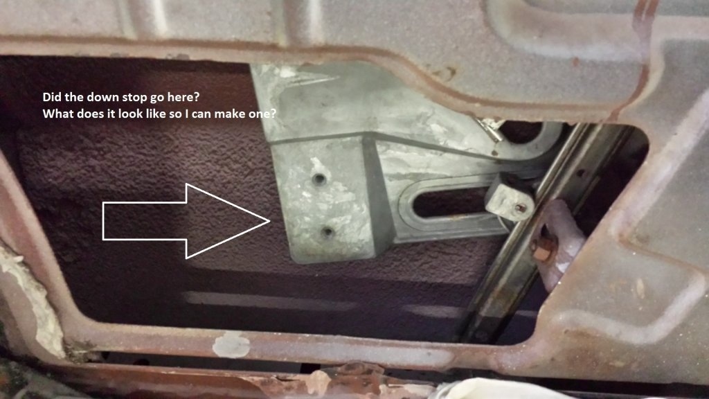

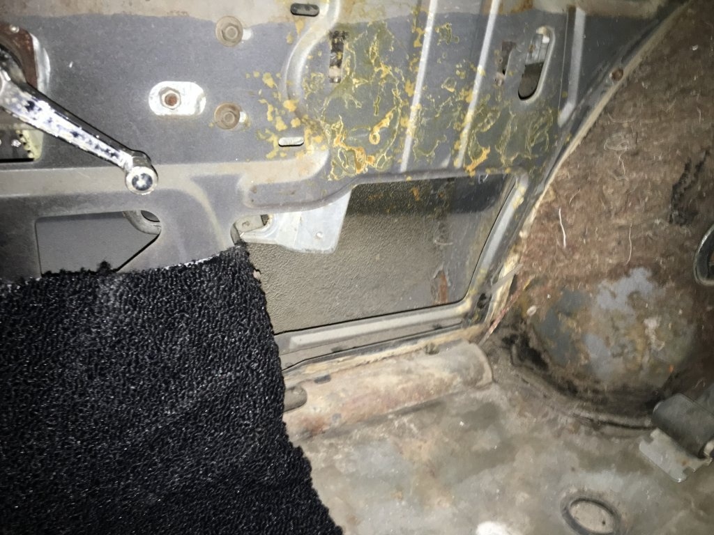

Do you or anyone have a picture of what a down stop looks like?
My car apparently didn't have any from the factory.
I can make something.

Well now I'm an a hole because I went out to my car and sure as hell no limit stops. I know they are on 68-70 cuz I did one three days ago. Been about 6 months since I did the cooper 67s and a year since my blue 67.
It was a bastard anyway. Now I can't get my window down to get fuzzies on my personal 66.

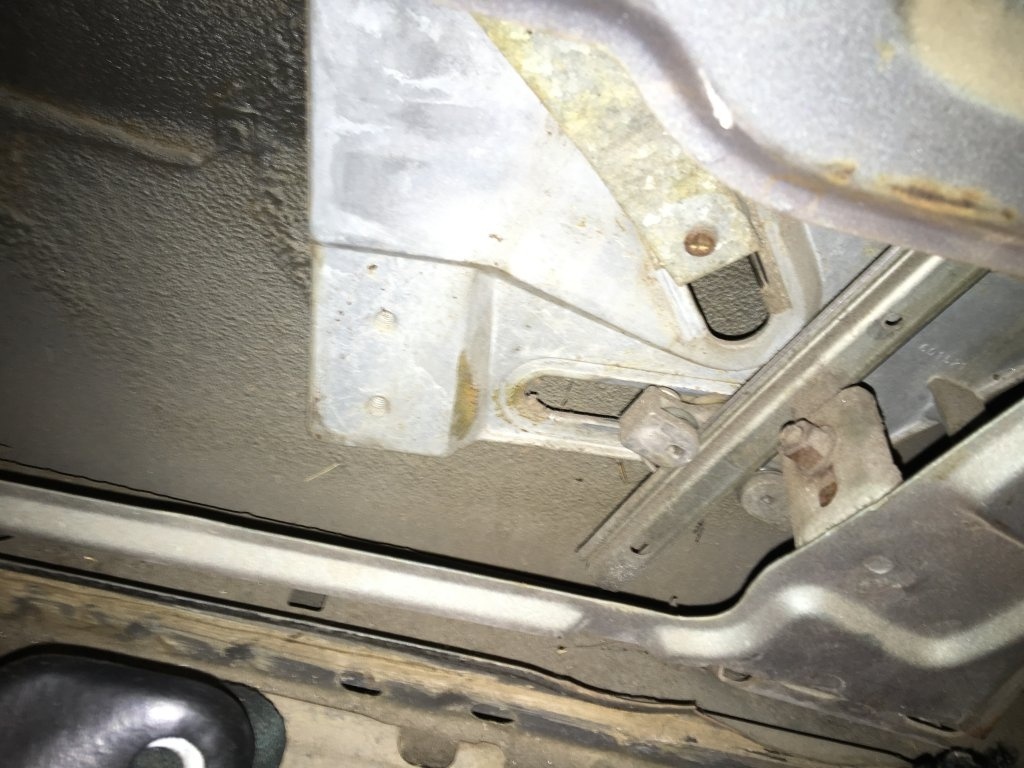

Ok it came back to me. No down stop because the rear regulator up down track is self limiting. Drop the regulator out and window comes down to get to fuzzies.

Oh. I see after posting that your regulator isn't attached ?
But I wouldn't want to even try and get the glass in with the fuzzy in place.
I don't think I would anyway.
Even with out stops this is as far as mine goes down and getting screws in straight would seem challenge.

Take the window fuzzies out and since 90% of the time you'll be replacing them.
Replace the typical rear broken or bent roller.
Put it all back together and then to get the new fuzzies back in, drop the window regulator (3 7/16 head bolts) back out and the window will drop down enough like mine in the pic, to replace the fuzzy on the outside edge.
