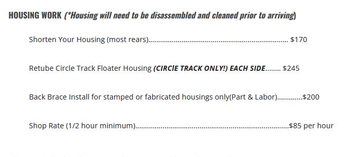

From Mosers web site.
Like I said above ...$1,800 minimum.
