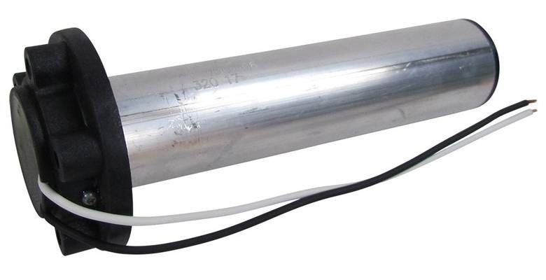

JMO but I would buy a Tanks Inc tank which doesn't use the standard sending unit... It uses a completely different design sender that actually works correctly...
The Tanks Inc tanks are intended for EFI but they sell a pick-up assembly for it that allows the tank to work with a carbureted vehicle...
What vehicle are you working on?
Sender I'm talking about... I've used four now & every one has been great...
I'm thinking it's your Coronet
Tank.... TCR9C-T
Sender T- ORG-08 10-73 Ohm 8"
Pickup assy PTA-G
Hardware kit 3G-KIT

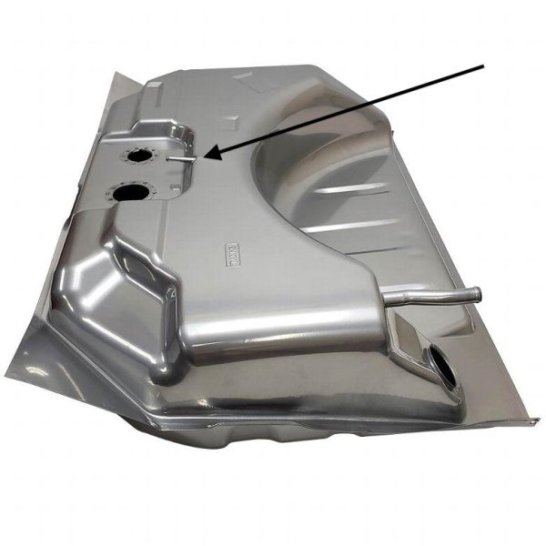

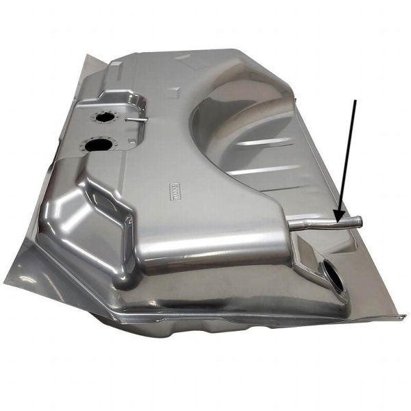

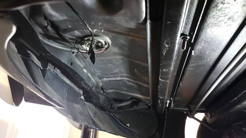

You need the vent, it allows the tank to fill properly and allows air in to the tank to displace fuel as it is used... A tank without a vent will be sucked flat on a long road trip... The tank I found a picture of is a C2 Corvette, They plugged the vent...
The tank comes with a vent valve that you mount and run a hose to.. I mount them in the shock crossmember...
Tank.... TCR9C-T
Pickup assy PTA-G
Hardware kit 3G-KIT

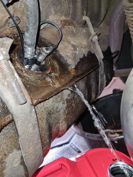

Today was a bit of a disastrous day for me. Yesterday, I pulled the fuel sending unit and discovered that is was a junk Chinese one that had replace the factory original. I tested it and realized it was a hopeless cause as the readings were vastly different than what they should be. I looked at the sender seal that was in the tank and figured I would install my new DMT one as that is best practice.
I have a proper tool, so no issues to reinstall. I did make a mistake though and did not lube up the lock ring. Fatal error.
It is hard to see there due to the rear end, but I felt it slide right back to the lock position. I figured for now, I will just live with the crappy sending unit unit I can find a good used or NOS factory original.
The cars rear end was up on ramps. I put 5 gallons back into the tank from my spare fuel container. I knew that it would take the fuel level above the sender seal. I left the car 24 hours to make sure there were no leaks. When I came back to it this morning, no sign of any leaks. I decided to go to the gas station and fill her up and make 100% sure that all was well.
I started to fill her up watching for leaks and there were none. Just as I got the 19 gallons into the tank, fuel started to pour out of the sending unit seal. This is the worst possible situation. I am at the gas station and gas is pouring out all over the forecourt.
I was able to quickly siphon enough to get back down to a level where the leak stopped. After the dust had settled, I realized what happened.
The tank lock ring holder split, the full tank of gas built up enough pressure to push the seal out and the result was what you see above. Its the original tank, so I can say it's had a life.
So, I am asking advice from the members here, what should I do? I have to pull the tank no matter what. Is it a dumb idea to try and weld that? I am thinking that it would be stupid to not get a new tank. If I buy a new tank, what company is the best? I have had great dealings from Jeff from 521 Restorations in the past, but I want a quality tank, not a junk one.
All inputs welcome please.

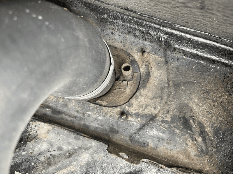

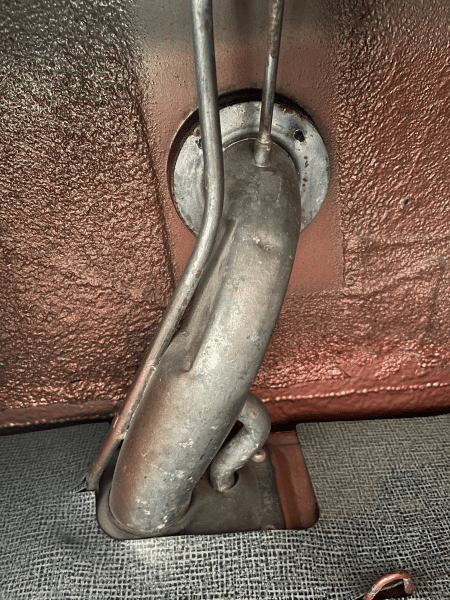

66-67 Dodge B bodies have a vented cap. That big vent line is only for filling the tank. 66- 67 Pymouth B bodys have a small vent line in the fuel filler in the trunk which then goes through the trunk floor, and a non vented cap.
Yes, I clearly need to get underneath and look at it closely. Thanks for the clarification.
I figured it was already venting somehow or I guess the factory tank would have collapsed in on itself by now.
That big vent line ends just below the filler cap and there is a double tube at the top, the vent is on the outside and the pump nozzle fits in the inside. As the fuel goes in the inside, it vents on the outside. With the cap on it is sealed up tight except for the vented cap on dodges and the little vent line on plymouths.
OK, seems clear now that the tank gets its venting (as it empties or builds any pressure) from the skinny line that goes from the top of the filler to the underside of the trunk.

Though honestly the tank looks pretty correct other than the fact it is powder coated silver instead of bare metal.... When I put the first one in I used the float style sender & it was just as bad as all the others... Then I saw a video about the floatless sender & read some reviews... I figured I was already this deep, might as well see if swapping senders would make the gauge work... I put it in & hooked it up... And for the first time in years I had a gauge that works...
Tried it on a second car & had the same result... Shocked... Third time? Perfect... Forth? Almost getting to the point I trust these things...

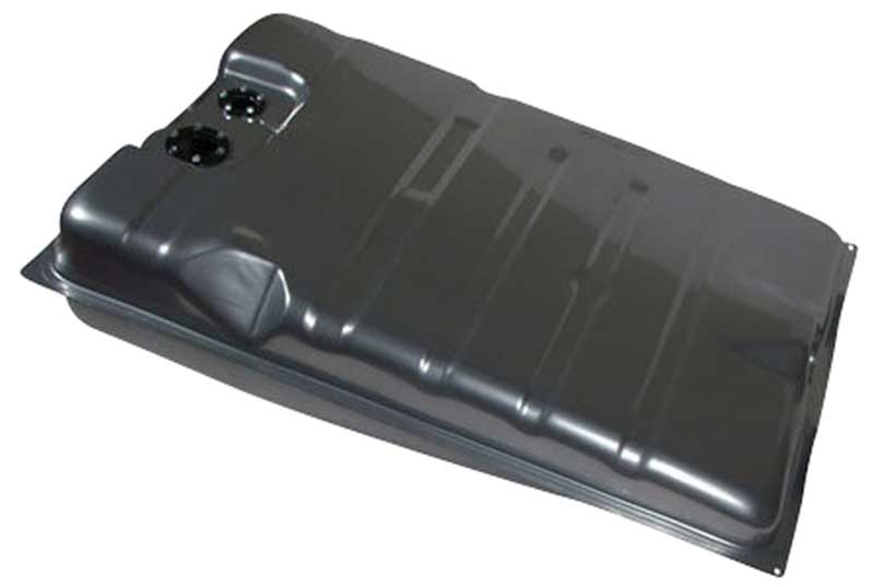

Well, you could cut out a section & weld/solder in a stepped down plate with the five bolt pattern... But trying to adapter the stock location won't work... The stock sender attaches to an angled spot of the front of the tank, the float less design goes in vertical...
