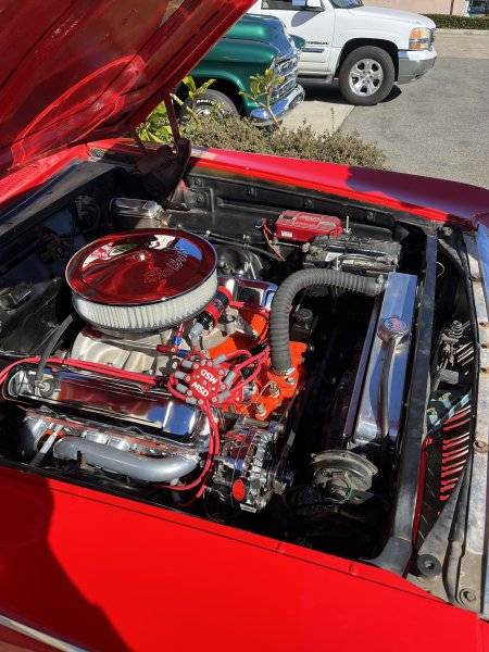

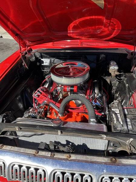

I have the 452;s on my 63 Polara 440 with a 750 dp on a RPM, CNC Stealths, Isky 292-242@50 108LSA. Flat tops with .039 gasket. 3000 stall and 2.94 gears. So yes it’s not a beast with these gears. But hit the pedal hard and 1st is a smoke show. Great fit with p/s.
