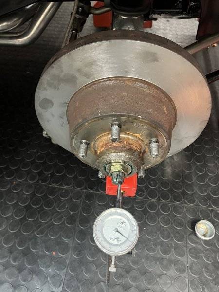

.001-.005”
Ideally zero end play, but you can’t measure zero. Probably overkill, but I set the bearings with a dial indicator to the least end play possible…
For drums, you tighten the nut to 90 in.lbs while rotating, then line up an open slot in the retainer with the cotter pin hole and back off one slot with the retainer in place before installing cotter. This will give between .000"-.003" endplay. I would think yours would use the same procedure. Confirm with your fsm.

.001-.005”
Is end play mainly to facilitate lubrication, in that if there was no movement, the included grease would have little chance of the rollers every being able tp "pick up" grease while rotating? Whereas if an oil bath bearing, seems end play as close to zero would be fine.
I have never read/heard a discussing of why end is actually needed for greased bearings. We are of course not discussing tight/bound bearing adjustments.
I believe some clearance is necessary to allow for thermal expansion as well. In the past I’ve worked on high speed jack shaft and fan assemblies that specified .008-.012 end play, they ran in an oil bath so maybe the extra clearance benefits lubrication. Going back to wheel ends, all of the formal training I’ve had from industry experts dictates .001-.005 end play. I had to document it on repair orders when I worked in the field, I guess old habits die hard…
But a fan has no impact loads, its a relative constant/load speed, unlike an on the road wheel assembly that might apply here.
Not sure how to address thermal issues. Do front discs that I believe run hotter in track conditions require even greater play to account for the higher temps? If so, I haven't heard that discussed before.
Not counting discs prefer zero end play regarding pad kickback, etc.
