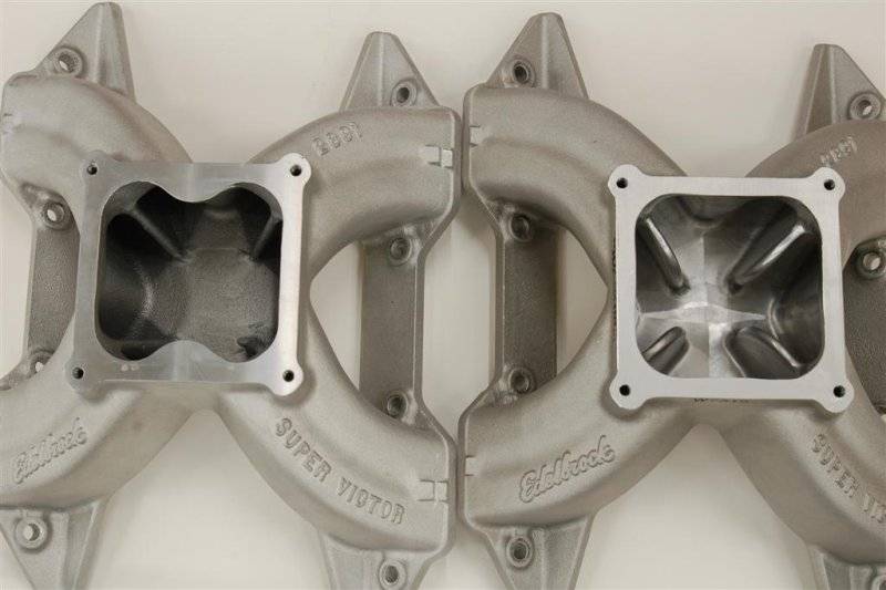

I had a really nice Wilson ported Super Victor on my 514 inch dyno mule. That engine was close to 900 hp with EZ heads. The intake picked up a lot of power of any as cast intake I tested it against but it did cost a bunch of money. I'll attach a few pictures.

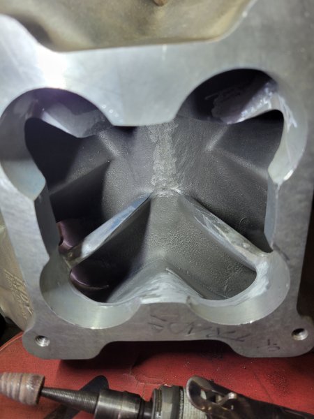

Interesting, I thought the hot tech was to knife edge the dividers. Here's the indy I cleaned up. It was the early one with the unfinished plunge cuts

Interesting, I thought the hot tech was to knife edge the dividers. Here's the indy I cleaned up. It was the early one with the unfinished plunge cuts View attachment 1661582
I don't think the knife edge works as well as the rounded nose but I don't port intake manifolds. I was interested to see how far Wilson extended the dividers into the plenum on the intake they did for me. That added a lot of material to that intake. I think it picked up around 30 hp from the mods.
Knife edging is not good. A rounded edge is prefered. An easy way to get a good edge is with a long strip of crocus cloth thru the pair of ports. As well as thru the carb opening from each port.
