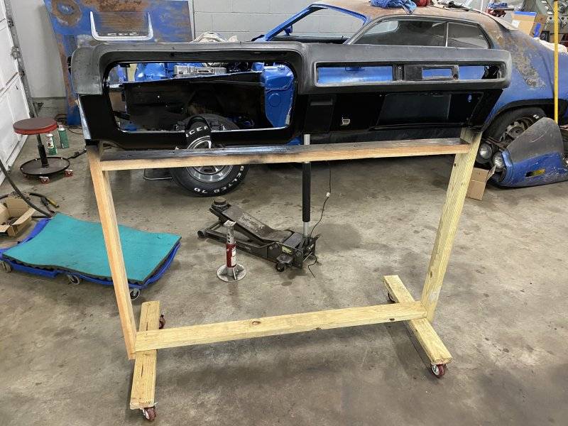

Has anyone built a dashboard assembly stand?

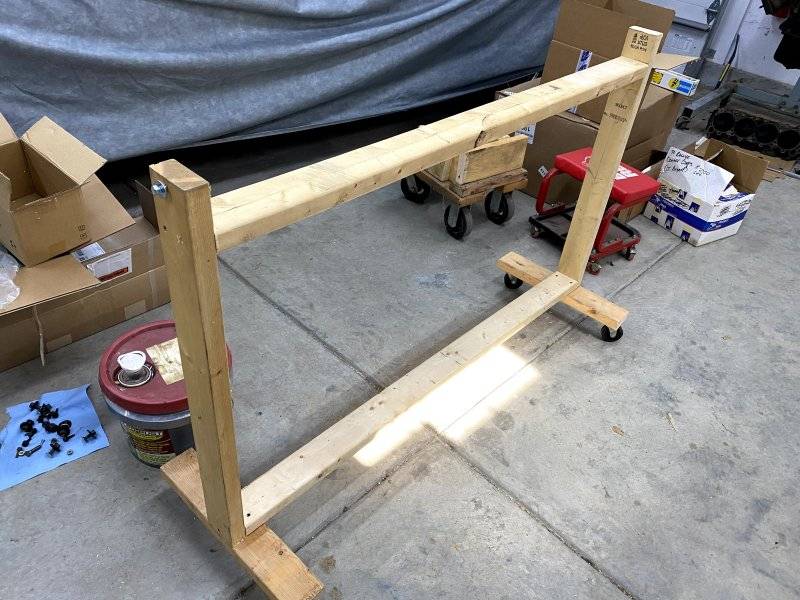

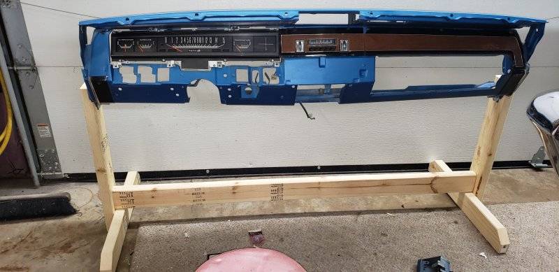

Just 2x4's

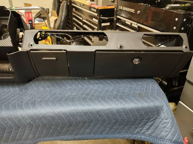

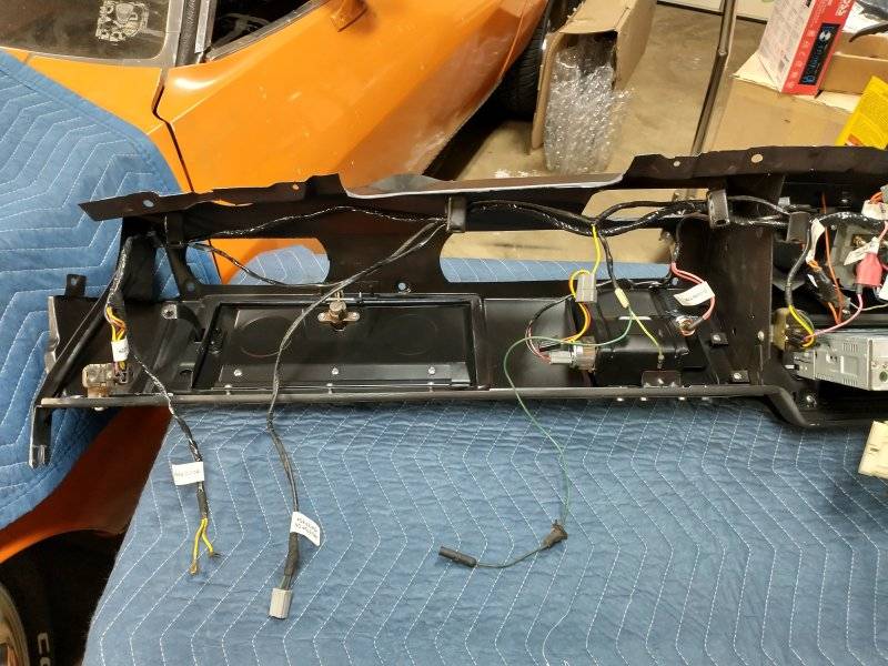

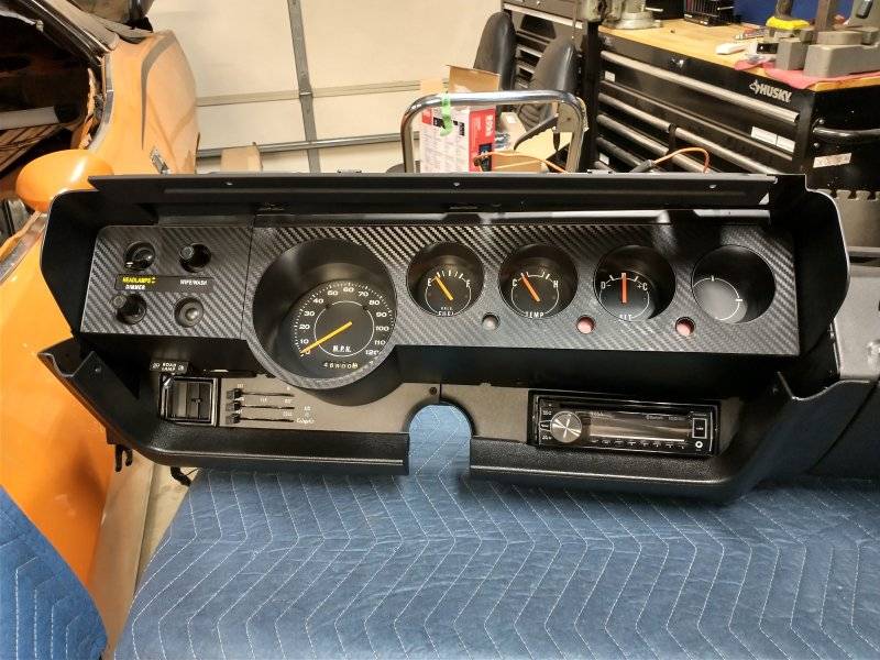

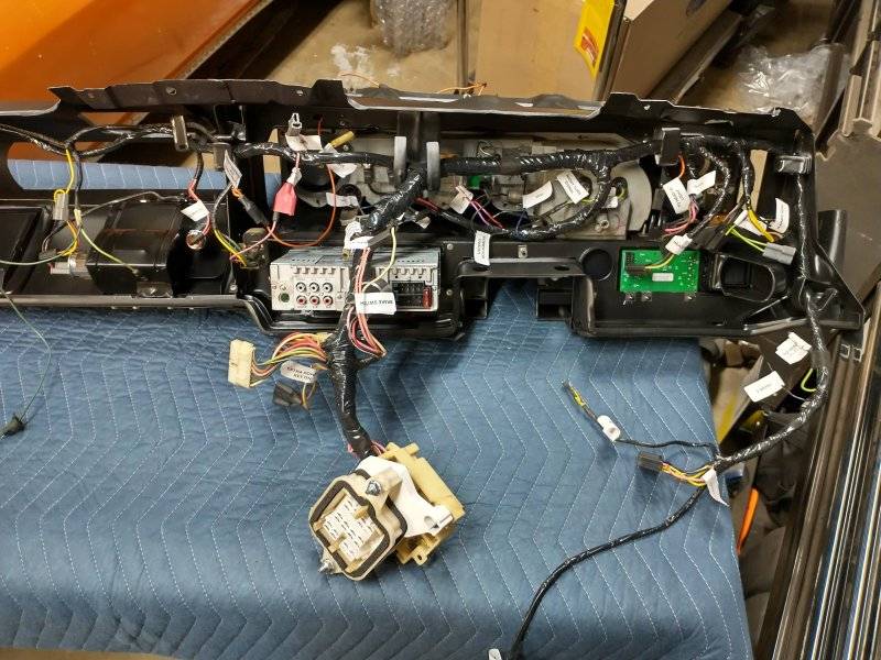

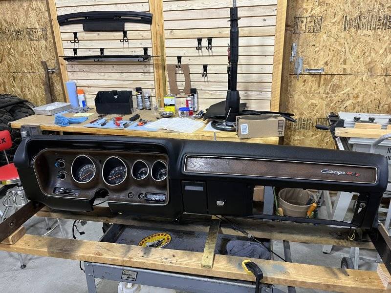

I just laid the 70 Cuda dash on a blanket on the car's hood for disassembly. I used a blanket on a folding table for reassembly.
No need to get fancy.

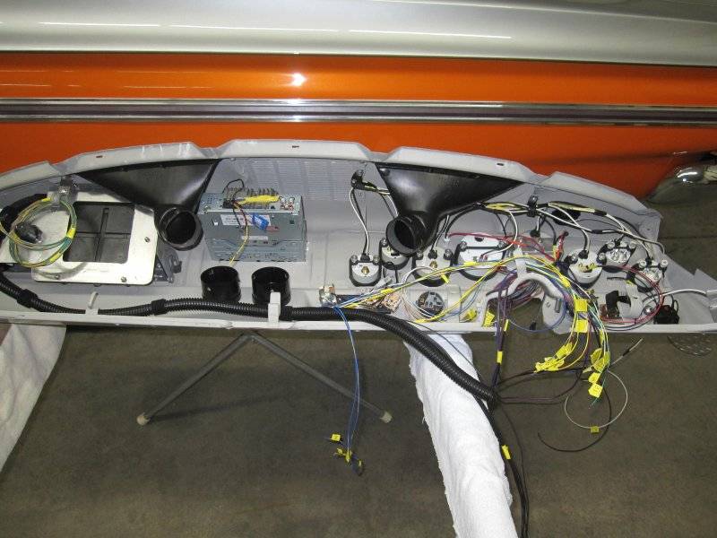

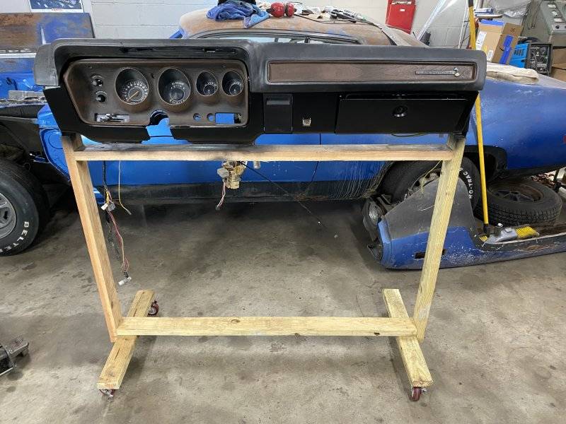

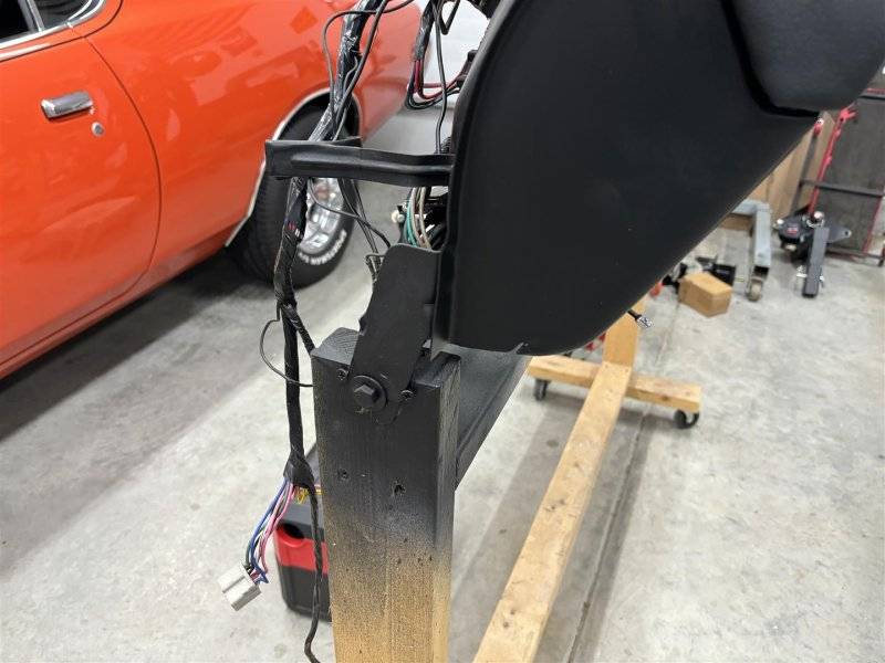

I copied Dodge Don's design for the taller one I had, then I built this shorter one for helping with wiring up he dash, installing the radio, etc.

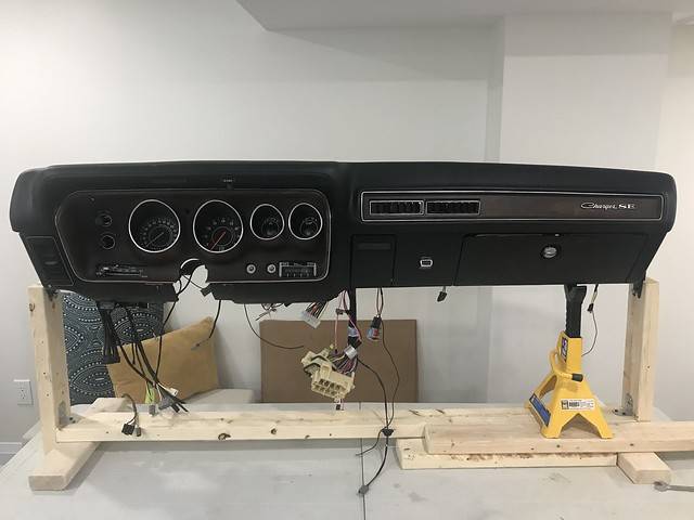

Similar to what others have posted. Just used what I had laying around.

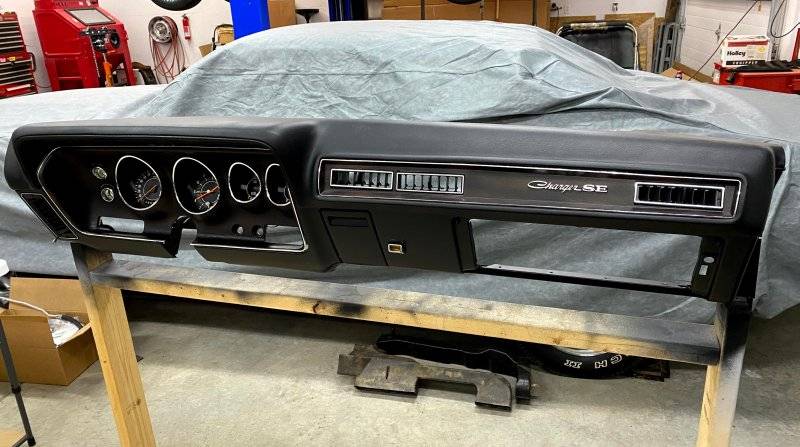

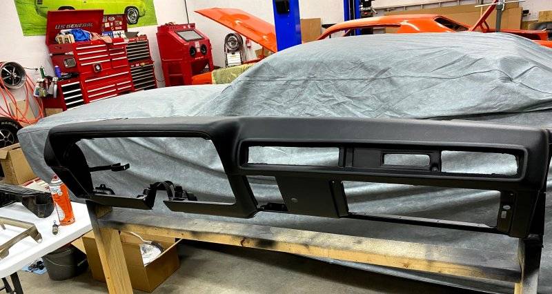

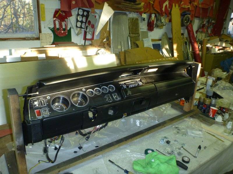

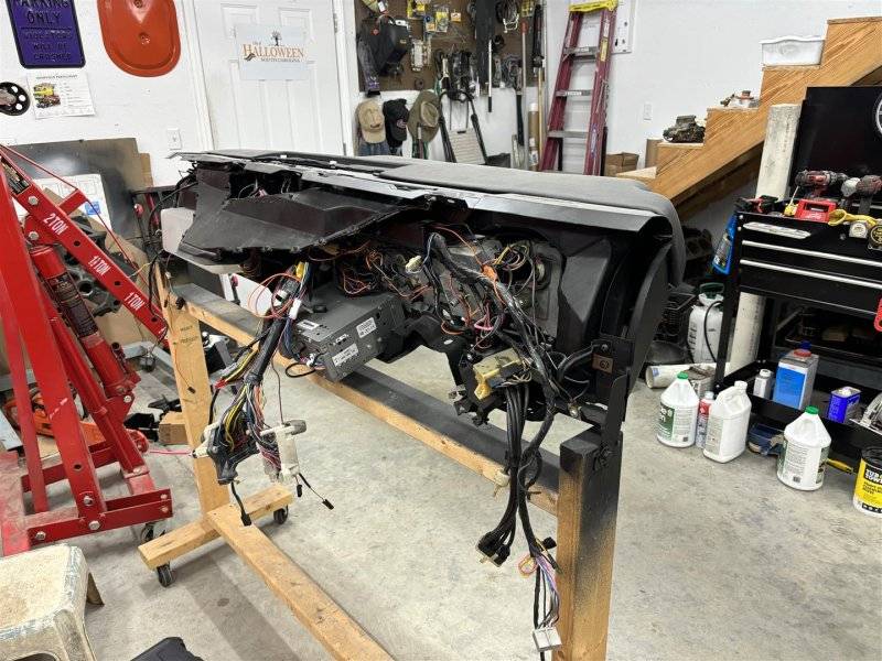

Nothing special, but allowed easy access to all sides for prep & primer………

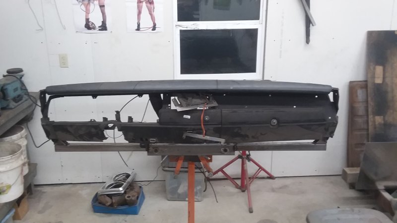

Just did this a couple weeks ago, I went looking for ideas and found one made to mount to an engine stand. I happen to have an extra one kicking around so whipped up a quick mount out of steel tubing, bolts where dash attaches to cowl sides and I made a support for the back for added security.
