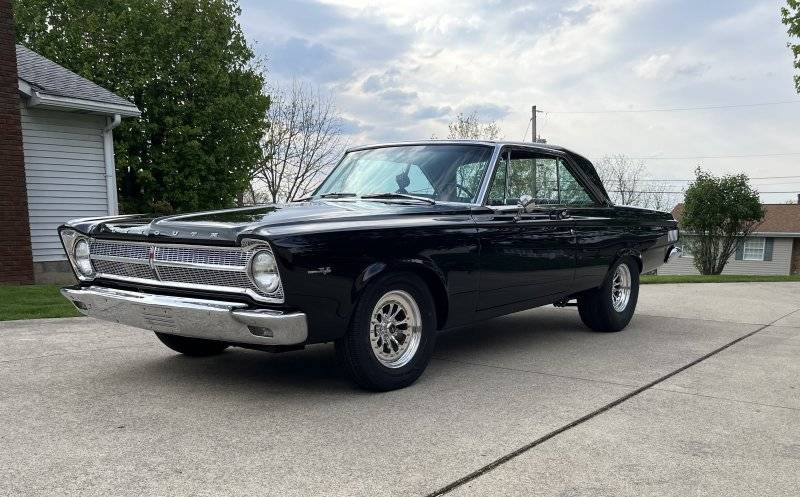

I’m currently Gen3 swapping my 65 Satellite after the 440 ate a cam after 1000 miles don’t know what to expect I am sticking with a carb set up to keep it semi old school and I’m using an engine plate instead of aftermarket mounts.
Opinion here but… I think the wedge stuff is gonna be harder to get and the quality not as good, and the new stuff is most often able to be bought off the shelf.

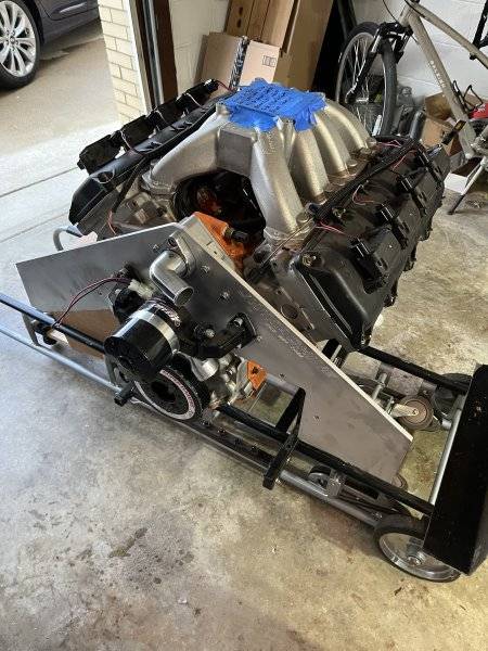

6.1 block stroked to 426 Molnar crank and rods Mahle pistons
Eagle heads ported
10.8.1 compression
Cam is 239/251 583/583. 112+2 centerline
Prefix intake and a 950 carb
Msd ignition
Assault water pump
ATI balancer

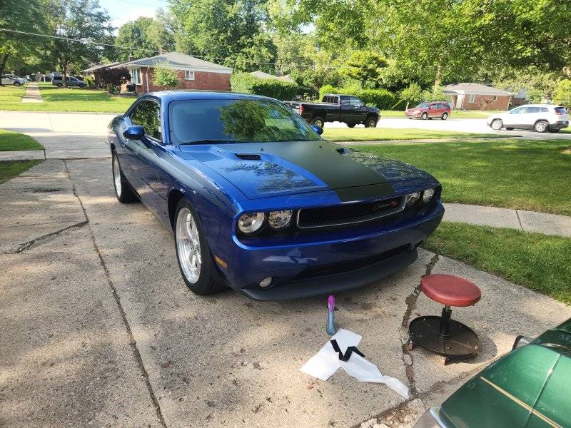

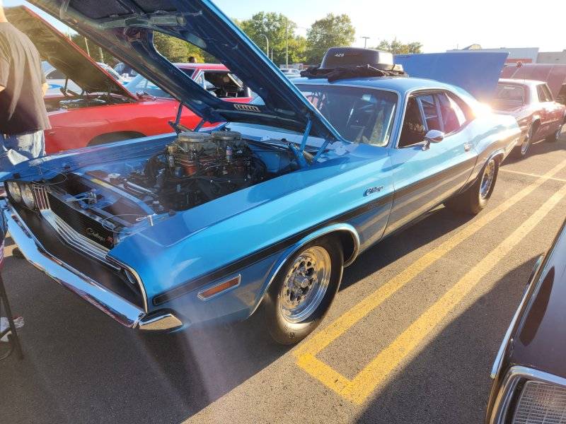

I own both. A 2012 Challenger R/T Classic with a 5.7L Hemi for my daily fair weather driver. And, also 3 other Gen II Hemi's. I have a 528" Hemi in my 70' Challenger currently. I like them both for different reasons. However, no matter what anyone says, as impressive as the Gen III Hemi's are with today's technology. They do not come close to comparing to a Gen II Hemi.
