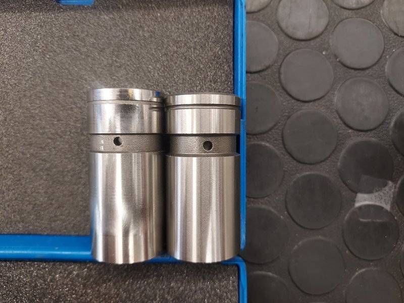

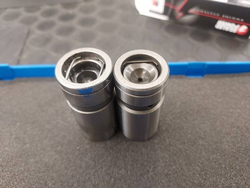

The lifter on the left appears to have a pushrod seat correct for the 68-newer pushrods.
I would be inclined to get two to match those, and update all the pushrods to the 68-newer style.
Rather than risking breaking in 16 new lifters.
Besides the 67-earlier pushrods having the smaller tip on one end, they’re also slightly longer than the 68-newer ones.
The lifter on the left is the Sealed-power HT-2011(or equivalent) style.
