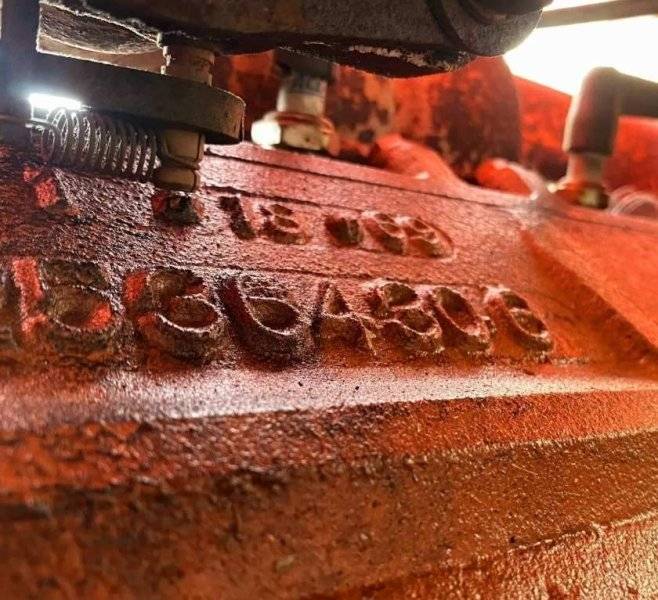

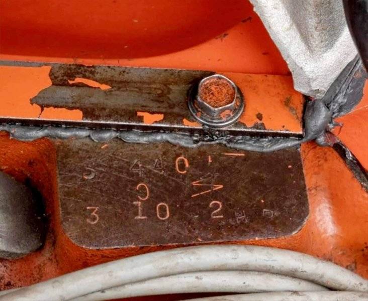

Looking at an A12. The engine was replaced but I’m a little confused about the stampings on the engine pad. Wondering if you guys could shed a little light . S 440?, casting on block is clearly 1/18/69, clean pad above the oil pan rail. Any info on the top engine pad and correlation to the casting date would help. I know the WT is water test but that’s about it.

It looks like a good 440 block to me. It has the stiffening ribs. Some guys like to see a casting date before the scheduled build date of the car. I ain’t one of them.
Oh… and it says “HP”. Again, that doesn’t really mean anything 50 years later.
What’s your take on the S440? Something cast in 69 shouldn’t that be a an E

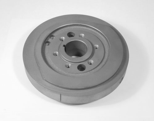

Things could have changed with the engine over the years but if it still has the Six Pack guts it should have a damper like this...
S is a service block replaced by the dealer under warrantee... or many years later by on owner to lead you to believe that. Is the pan rail "pad" still milled or smooth?

S=service (warranty replacement). That's why no Vin on the pan rail.
A12 would be a 69 1/2, light rod motor, neutral balancer. 70-up v code would be a heavy rod motor with a counterweighted balancer.
That picture of the pan rail pad is low resolution but appears to be milled and blank

69 440 6 engine normal balancer and rods .......1970 heavier balancer and rods .....looks like a replacement engine to me with no vin

S is over the counter service block.
Doesn't necessarily mean warranty block.
