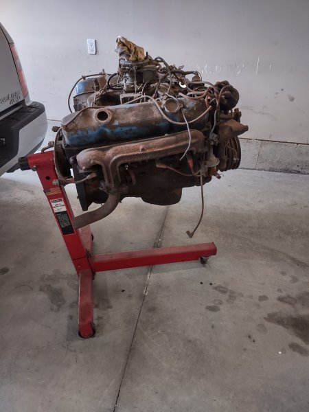

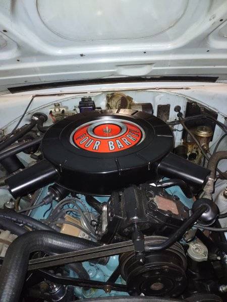

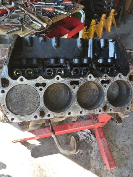

I said I would start a new thread once I started my new 400 build. By way of background, my Charger is still sporting it's original 361 engine, with a small cam and four barrel intake. The goal is to build a stock stroke 400 which will provide more torque to move the 4000 pound car , while still retaining good street manners and mileage. The car has stock exhaust manifolds with dual exhaust, and retains it's original 2.94 rear gears. I figured the increase of 45 cubic inches and a slightly hotter cam should do the trick.
Here is the donor engine, out of a 73 Chrysler, apparently with only 29,000 miles

I like more gear personally

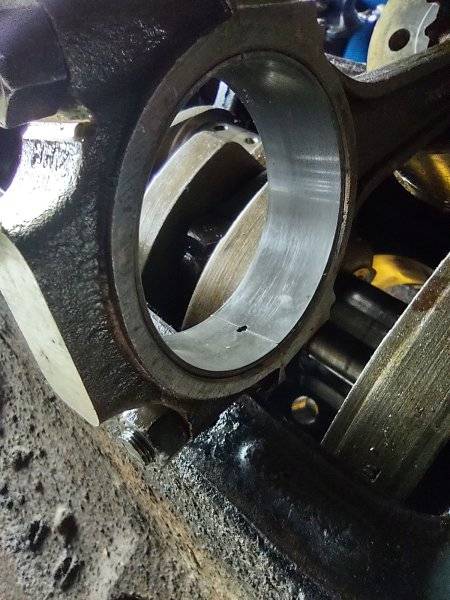

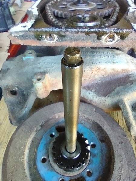

The engine had lost oil pressure, and was parked. Once I pulled it apart, I found the culprit. The oil pump had been removed, so I didn't have a chance to see what caused the oil pump drive to break.

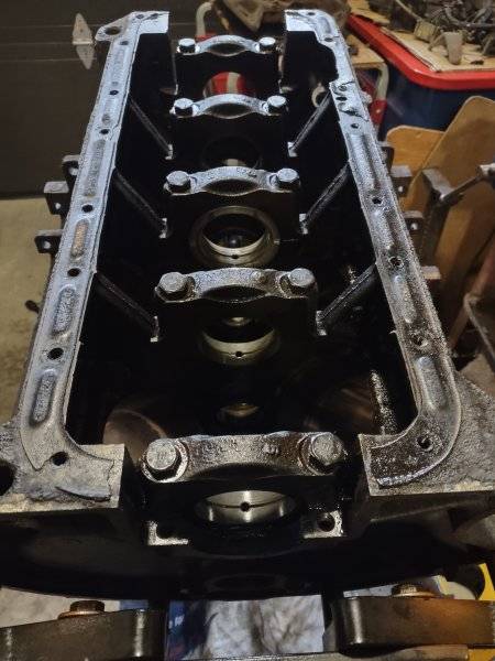

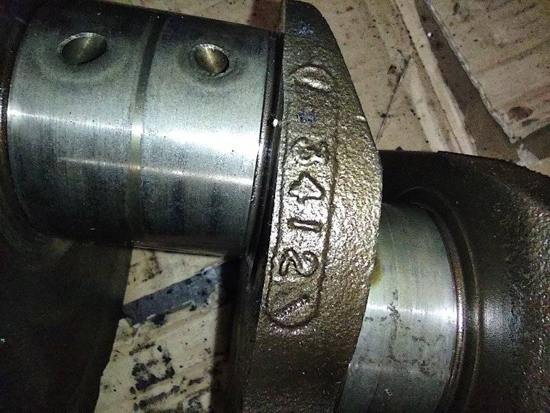

The engine had .010 under main bearings from the factory. The bearings all looked good, and we may be able to get away with just polishing the crank.

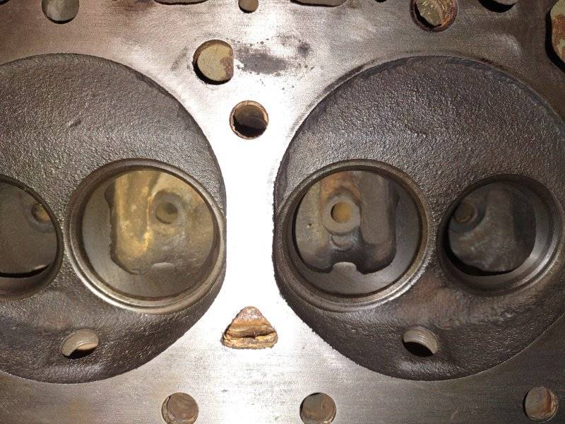

I am just waiting for the heads to come back from the machine shop. They have been cleaned, and they are going to plunge cut them and return them to me to finish porting. The block crank and rods will be dropped off at the same time to be cleaned and checked. Once I get them back I will post some further pictures.

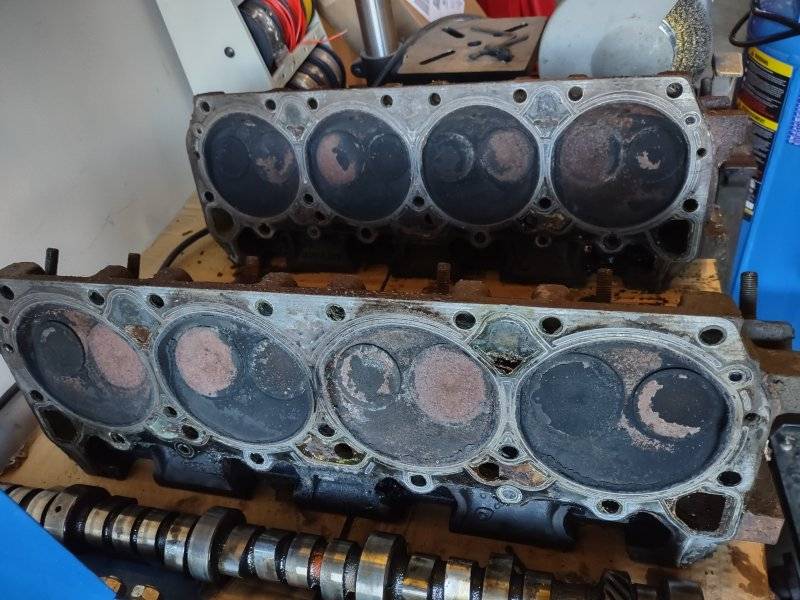

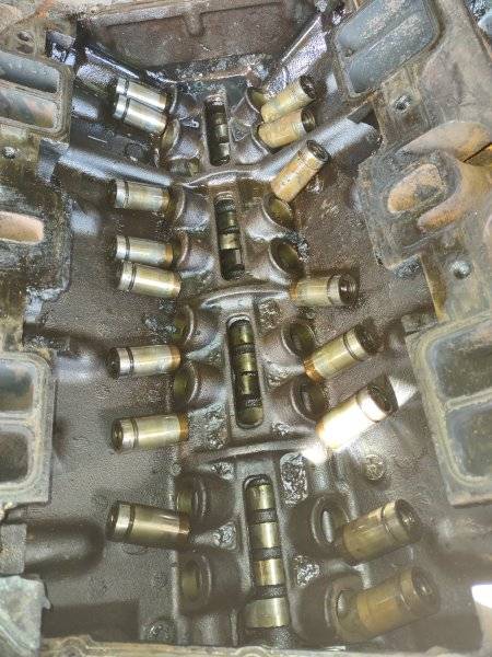

I'm still waiting for the heads to be ready for pick up so I can drop off the block. I found something odd which explains why the last three lifters on the drivers side were stuck in their bores. The oil gallery was plugged with what looked like a mixture of sand and sludge. I had to use a drift punch as a ram rod to clean it out. This might also relate to the oil pump seizing up?
Someone dumped sugar or salt into it.......?
My first thought was casting sand. I am thinking that spot is the dead end of the oil gallery?

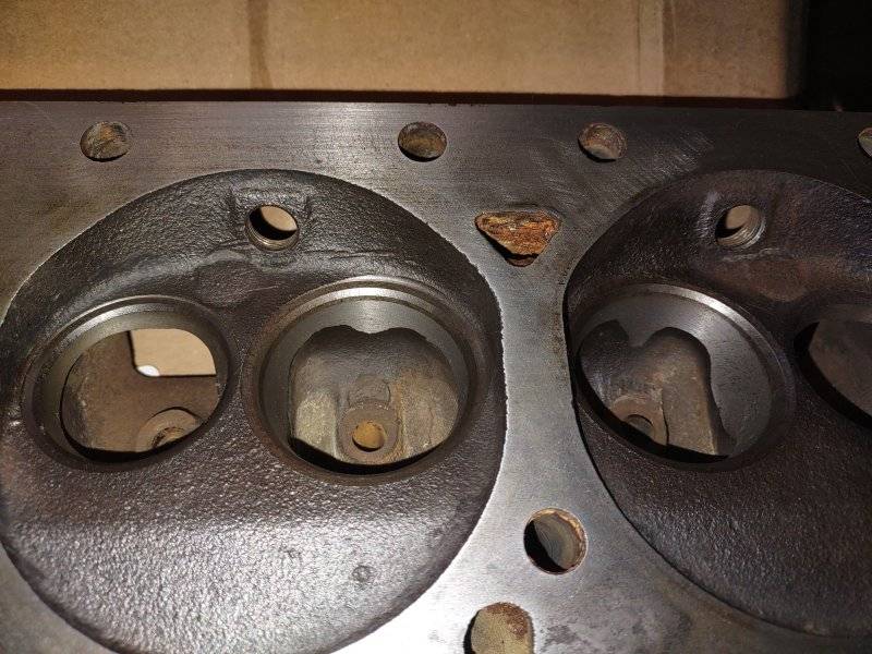

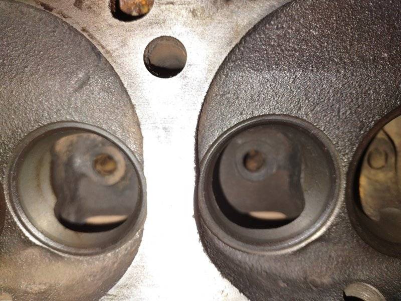

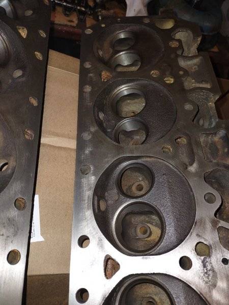

I haven't posted lately, as I was waiting for my heads to come back from the machine shop. The valves and guides checked out great, and they plunge cut the throats, ready for me to finish the bowl blend and short sides.

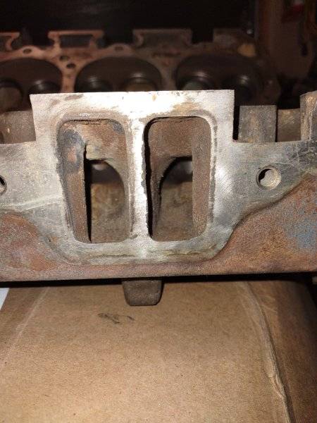

I may also port match the intakes as they are a little rough.
