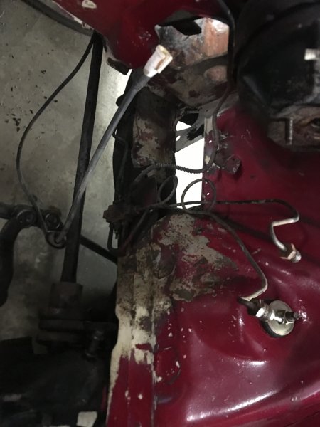

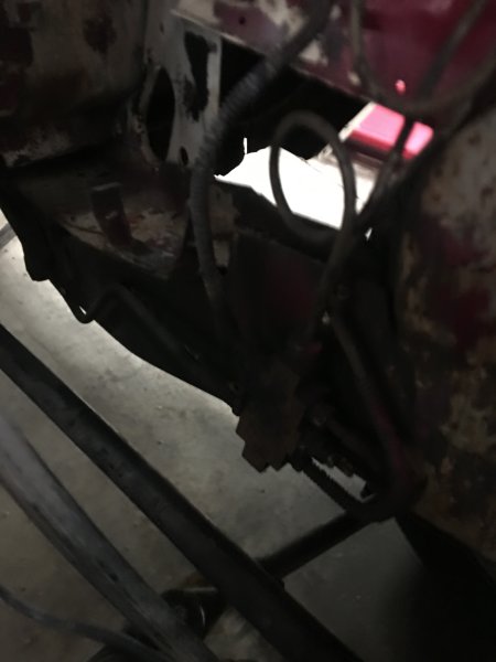

Strip it, and clean it good and use the best materials you can afford and get. Just remember you don’t want to do it again. I’m currently doing my engine bay on my 68. It was born white, then got a bad black coat over the car, then two different shades of red... but no rust!!!! So I can handle it! It will be done in the correct red for 68 not white, engine is getting overhauled as is everything else , it’s being driven and it’s for my wife and family to enjoy so I want it to be the best it can be.

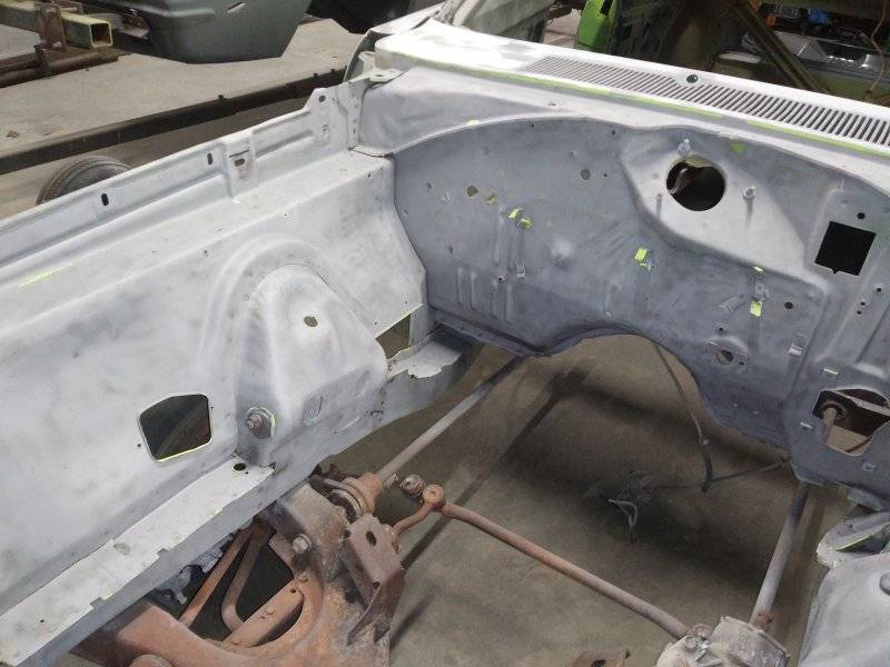

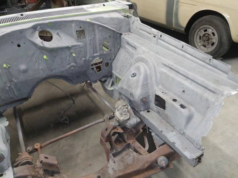

I’m using walnut shells on my 68, I have removed every thing and preparing to blast it next week. I was told they are a good option. I have remove everything on mine.

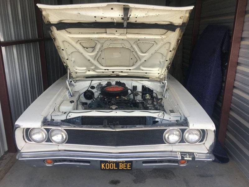

Some dumbass kid (me) spray-bombed my bees engine bay black back in the 70’s. In 1997 it took me and my cousin 40 man-hours removing everything, cleaning, scrubbing, sanding and wiping down repeatedly with wax and grease remover. We then primed the bare metal spots, and sprayed sealer over primer and factory paint. Then tacked it 3-4 times and shot factory color with single stage catalyzed enamel right in my driveway. Turned out great, still looks great today, but man it was a lot of work. Do it right or do it twice. Good luck.
