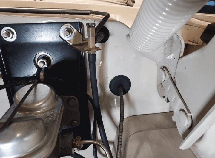

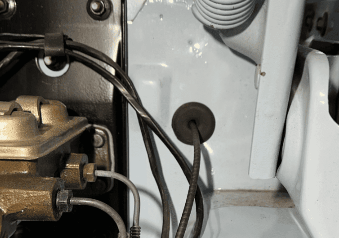

Photo of my car, 1962 Plymouth Savoy (orig 318 Car)
Speedometer cable Firewall hole is exactly at the Choke cable location, based on the template provided by the Max Wedge Dual Choke Cable (MWDCC)instructions
Location of Speedometer cable not at the standard location (that being lower and to the right - above the fender "deck")

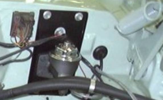

KhryslerKids Dodge Polara 500
Location of Speedometer cable also at location of MWDCC location (The more common being lower and to the right - above the fender "deck")

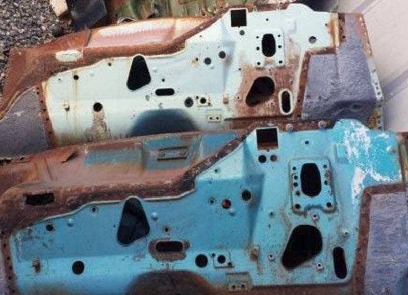

Unknown Firewalls look to be 1962/1963 though
Top one Speedometer passthrough hole at standard location
Bottom one interestingly no choke cable OR Speedo cable passthrough hole

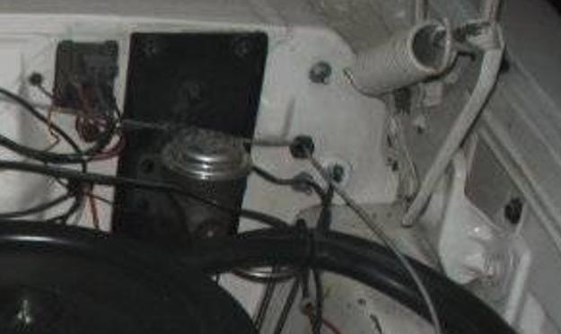

1962 Dodge or Plymouth (Photo clipped from MoparMall.com Push Button/E Brake Grommet listing)
Speedometer Cable location at the Choke cable location
What appears to be a choke cable is in a non-standard location, likley aftermarket location

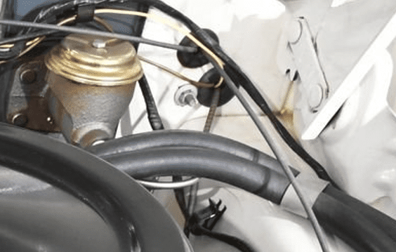

1962 Plymouth Savoy, VIN: 2121154921 Photo from classiccars.com listing
Speedometer cable passthrough hole at standard location, lower to amd more above fender "deck"

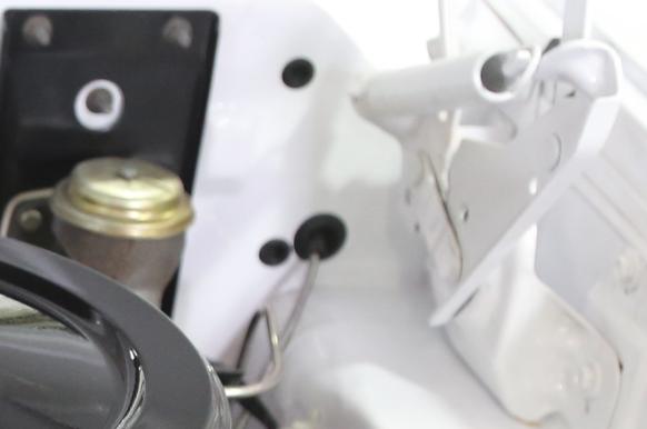

1962 Dodge Dart, VIN 5122166109
Both Speedometer location (Lower)
And Dual Choke location (upper) are in most common location
