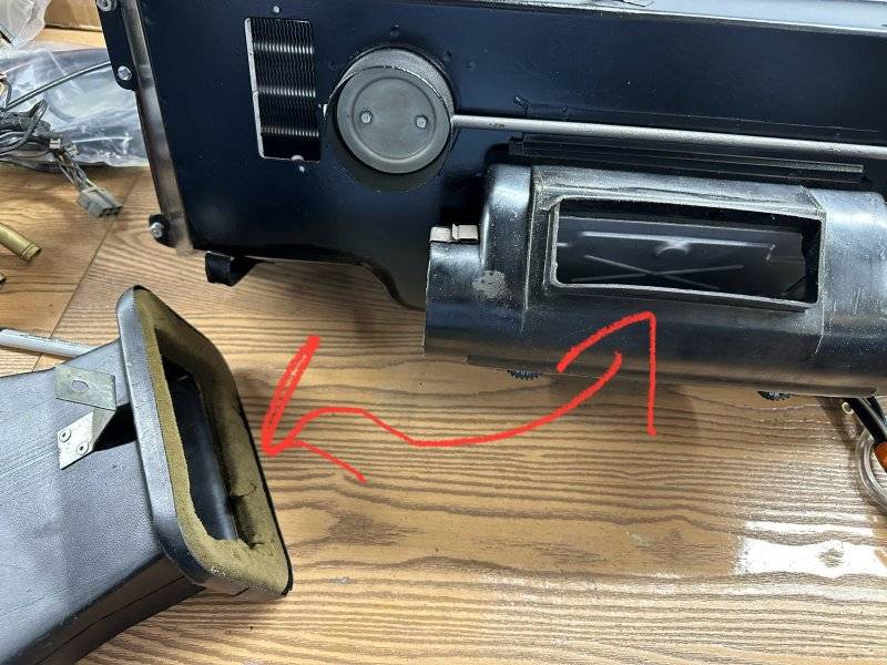

See pic….Is there a flex duct that goes between these in the middle ac vent (Rallye dash)? If so where could I source?
I have new duct for the end vents, could buy online. Have not seen what would bridge the gap here. TIA.

You're not missing anything. Those two pieces just fit together, piece on left button up against center vent. Pretty sloppy fit.
The foam is supposed to create a seal with the piece that connects the center vent registers..

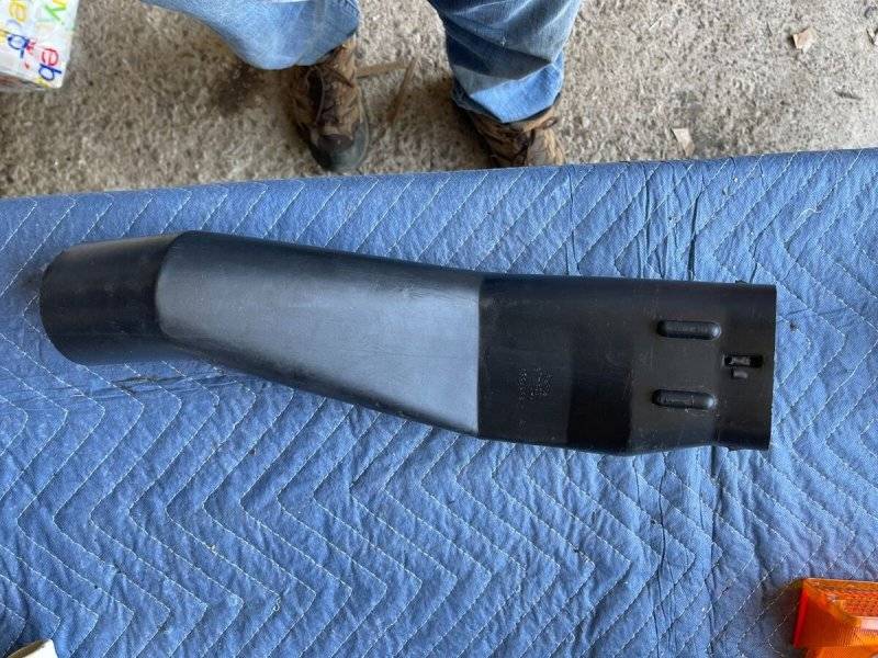

The piece Dave posted connects to the round outlet on the left side of the plenum & travels over the steering column then a flex duct connects to the drivers side lower dash vent..
Thanks. I'll look into sourcing that part.

your post cleared things up for me, I sourced that part on Ebay and ordered it, about $40 with shipping....there were some of the same thing on there for $100 plus
many thanks for the help! Got all those parts now....I think lol

There is another piece of foam that you are missing in the pic that goes around the outlet opening also. Detroit Muscle has both of the required foam pcs available new.
Yes I have both. Thanks. I ordered an entire kit from DM some time back and forgot that I had it. I have all the pieces of that puzzle now thanks to the good advice on this forum.
