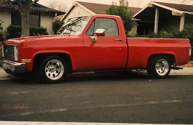

In 2003, I used a chain to pull out a post in my front yard. I had the chain wrapped around the axle of my 1984 Chevy truck. The drive to work the next day was weird. I had a strange rumble and hum in the truck the whole time. It took me a couple days to discover that the welds on the spring pads on the axle had peeled up. The pinion angle was WAY out of whack. I fixed it and had new U joints pressed in since I figured they were going to fail as a result.
