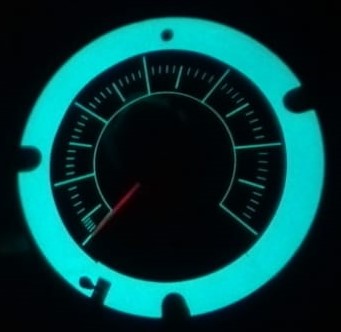

Hi all.
I´m in the process of repair funcionality and renew the gauges faces.
I have get all the gauges working a polished gauge surfaces from almost white to total black.
The only thing resting is a needle that only glows half lenght sometimes, sometimes glows complete.
I think it must be a circular haircrack around the neddle.
My solution would be to scrape the orange paint and aply a light coat of conductive paint in that area, and then coat with new paint.
I don´t know if it´s the correct way.
Also, I think all the needles glows little (all ones the same), or could be the much bigger glow of the circular ring when it´s out of it´s receptacle overlaps the needles.
If some of you have battled with that little thing, I would grated with some help here.
