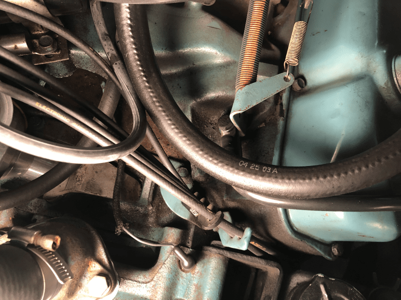

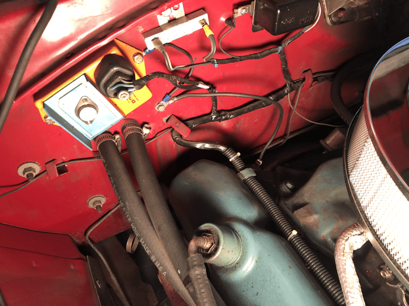

On my 66, front ground lug from battery is under bolt that holds the Z bracket for the springs for tranny linkage.
Rear gnd is a bolt at rear of the block to firewall.
