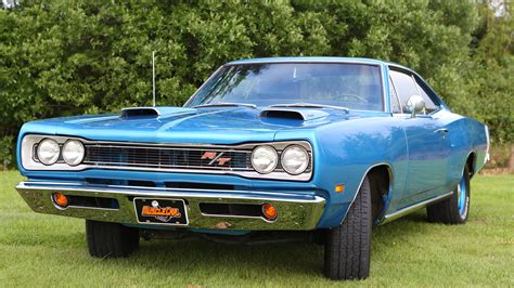

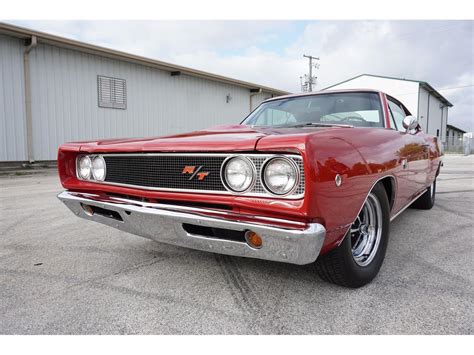

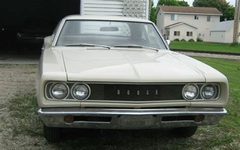

Hello just wondering will a 1969 Coronet grille bolt straight in to a 1968 coronet
Doesn't look like it
The filler between grille and bumper is a different shape.
The fenders are shaped different

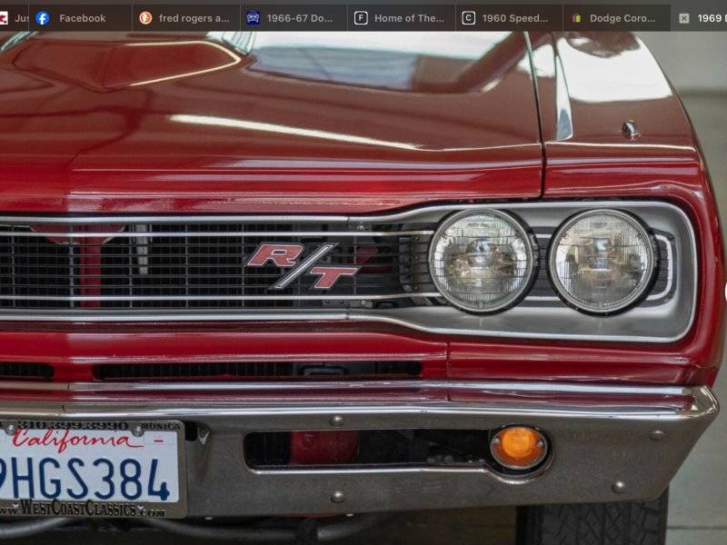

69 has an extra piece screwed to the bottom edge of the hood to fill in for the tapered 69 grill
Hoods are the same and where it ends. As R413 stated, the 69 got a filler strip to make the grill work and the lower is shaped differently.

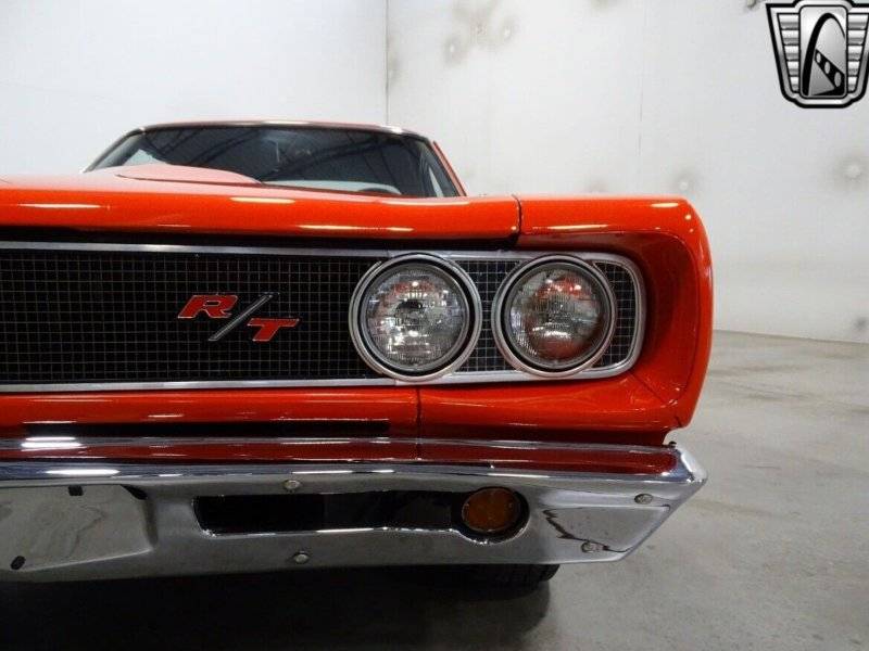

I thought the fenders interchange because of the taper- the 69 grill sits to the front, while the 68 is recessed.
...and the difference was the top and bottom (below the grill and on the hood) filler panels.
Everything looks different to me. You better just get the right stuff. Can of worms... What are you trying to do?

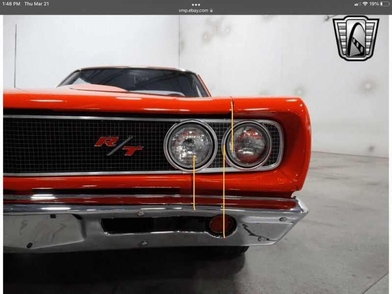

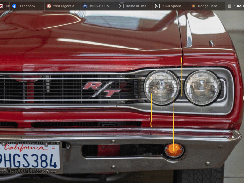

Look at the seam where the lower filler panel meets the fender, line that seam up with the hi beam headlamp. They are different, so are the headlights moved, or is the length of the lower filler different?
The headlights are not in the same place left to right.
Line them up with the hood/fender edge, park lamp, and seam where fender and lower filler meet.
They did the same thing between 1967-1967, moved the headlights over.
