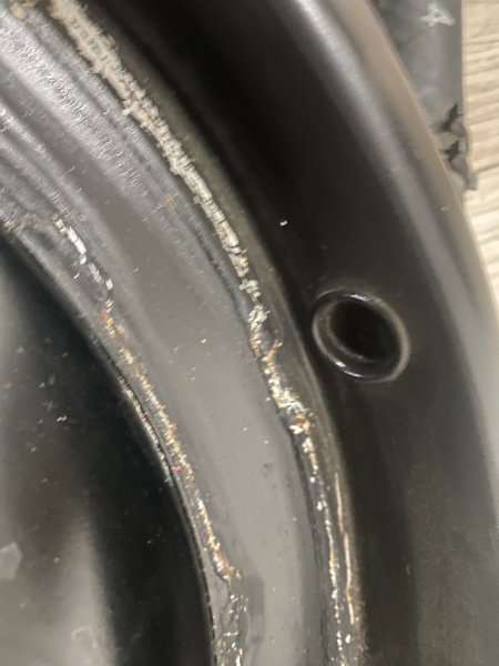

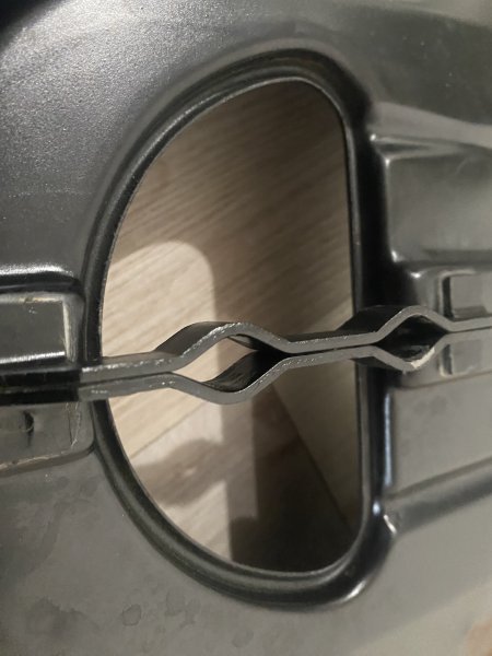

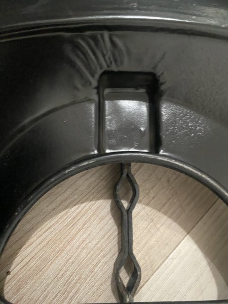

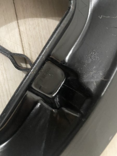

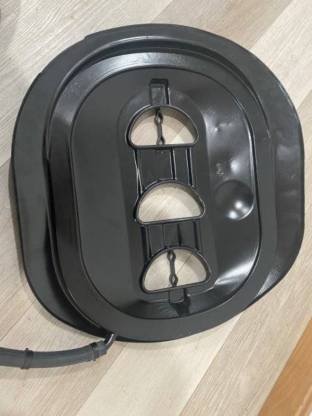

Any idea of this is original or not. I can’t find any stamps. Assuming a repro. It’s a little banged up so I’m going to swap it out for a nicer one.
Looks like a repop...it's got the notch on the wrong side on the front
It’s not supposed to be on the distributor side like it is? I saw a low mile original survivor 1970 car with it on the same side. I was thinking the notch’s when on the drivers side were a mopar performance release from years ago. Couldn’t remember the scoop with originals or if some reproduced parts also had it on the distributor side.
Good eyes! Notch is correct... couple a to many Pilsners!
