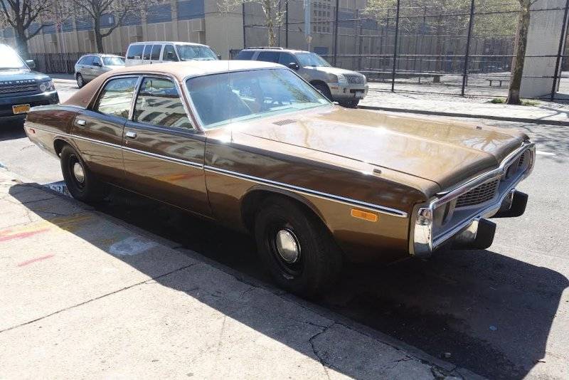

I was on the Hutchinson River Parkway in Westchester, NY the other day and came up next to this '73 Coronet 4 door dressed up like a cop car. This thing sounded pretty good too, definitely a big block rumble. (note the R/T badge on the trunk) After a few miles, they turned off at an exit behind me and I caught a glimpse of the front end of it in the mirror - man, it actually looked downright mean. With the long hood and tunnel grill it definitely has muscle car bones. The plush police dog cracked me up.

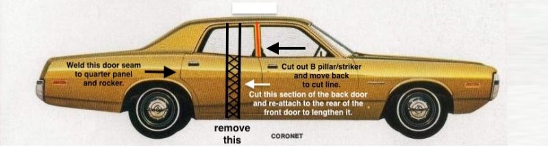

My thought was to cut/re-use the existing B-pillar/door jamb section and 'just' move it back.
Then, you'd basically section the rear door by taking a few inches out of it in the middle. You'd weld the rearward side of the rear door into the quarter panel. You'd have to cut the rear door striker area out though and figure out what to do with the space left. Probably best to cut the entire door and weld it all in place as a whole to keep the window channel and provide rigidity along the bottom.
I'm convinced the door would be the most difficult part to get right. You'd have to separate the latch section from the skins and then graft the rear section to that. And, since the body line changes in the middle of the rear window and on the bottom as well you'd have to add some height and do some body work to get it all to match up.
I saw a picture of one someone made,but they just welded the rear doors shut and didn't move the b pillars back and lengthen the doors. I think it could be done to look factory, like the drawing. I would use the inner door structure from a third generation Charger, and attach two pieces of the Coronet skin and upper door window frames to accomplish the lengthening of the doors. I would probably use the rear of the door jambs from a Charger to receive the inner door structure and have them latch properly. I would use the upper part of the b pillars from the 4 door to receive the upper window frames. It may require a second set of 4 door doors to cut up to make all the pieces jibe and have enough material to do the job. If you have a welder and aren't afraid to tear into it anything is possible! I built both these Charger convertibles. If you want to build a one off Mopar,you just gotta tear into it and make it happen.

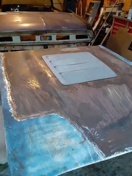

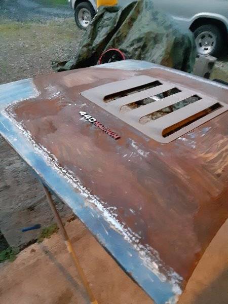

I made this hood for my 70 Charger R/T SE. A hidden headlight grille would also be a nice upgrade for a Coronet.

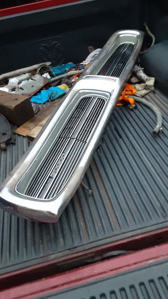

A friend showed me a photo of those headlights in a Coronet... they used the whole Charger bumper and headlights. Can't decide if I like it or not.
