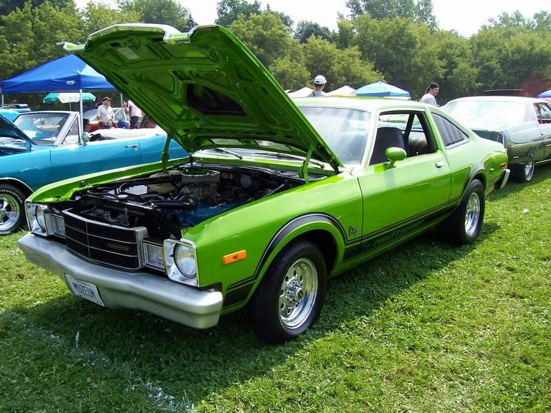

I had the same issue on my 76 Volare Road runner.
When I bought it - it had an 8 3/4 from a 66 Charger.
All I did was have a bushing machined to fit inside the isolator hole and a small hole in the center of the bushing to locate the leaf spring pin.

Thanks for the replies, and I may not be a huge fan of that body style, but green is my favorite color, and it's easy to say that is a sweet ride!
No additional modifications were done.
The height of the bushings I had made were to sit flush with the top of the ISO perches.
Shocks did not need to be changed.
As far as a height difference in the rear, I did not notice any - but the reason for that was my leaf springs were tired - so I had them re-arched which did bring the height up slightly.
As far as retaining a rear sway bar - a rear bar from an earlier B-body, like a Charger may work well.
I plan on installing a rear bar on my nearly finished 71 Runner - the bar came from a 1971 Charger which did not have the ISO setup in those early years.
