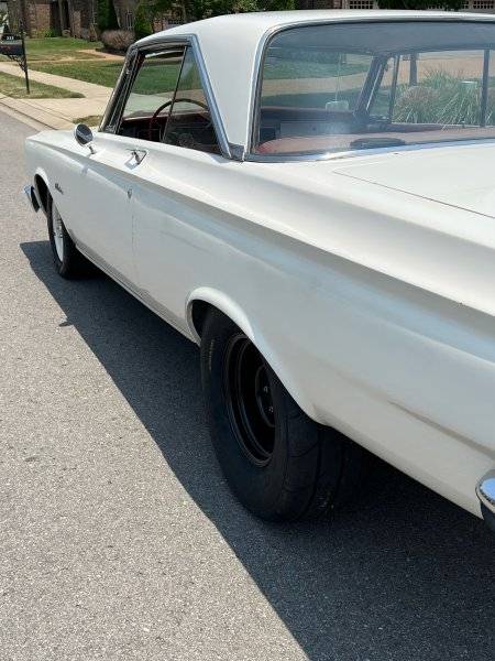

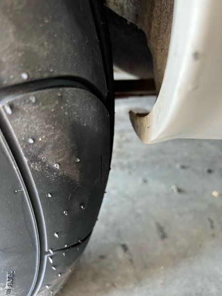

I have been wondering about tire size and what is the biggest that will fit on a 65 Belvedere. After reading so many comments about 255's being the biggest, with an occassional 275 being the biggest, I decided to find out for myself. I did find 2 posts of people that fit a 295x65x15, so that was my goal.
Here are my photos of that tire (Mickey Thompson 255508 - Mickey Thompson ET Street S/S Tires) mounted on 15x8 with 4.5 inch backspace rims (Wheel Vintiques 63-5812042 - Wheel Vintiques 63 Series). The previous owner of my car rolled the fender lip, but I am sure they would fit even it the lip was not rolled.
Now I need to finalize the fronts....
Hopefully this will help someone who is wondering if these tires would fit.

Thank you for this. I have owned several early "B's" and only went with 275/60/15 as the largest.
As well known, no two cars are the same so there will be many + or - to make things fit.

I think the backspacing is key for this tire. the 15x8 with 4.5 inch backspacing puts the tire right in the middle of my wheel well. I have also ready that the Mickey Thompsons measure out different than other tires, so that could affect things. You are 100% right though, no two cars are exactly the same, so it may take some figuring. I saw a few other 65 Belvedere's running this size, so I knew I could make it work. I wanted to get the tallest tire I could on the back to mellow out the 4.56 gears, and because I like the look of these old cars with tall tires on them. I hope this will help someone.
Agree on backspace. It's critical to get the bs right if you want to run the most tire. My current setup is the old centerline autodrag 8 1/2 with 4 7/8 bs, but I need to use a .300 and .330 spacer, so essentially the same as yours.

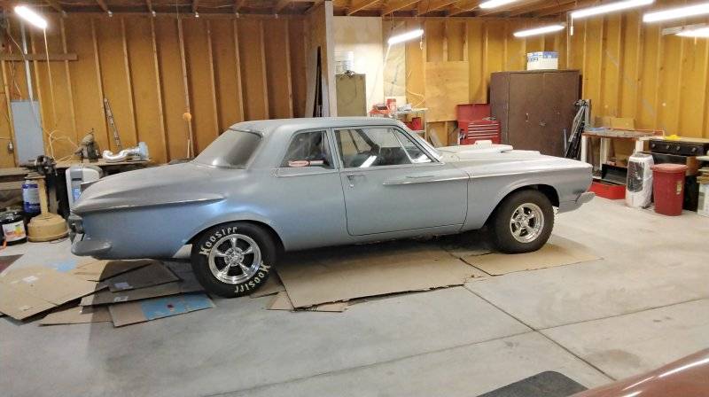

Tall as you can, on the front? I'm running 235/75x15s on a seven inch TT2 rim on the front of my 62. 29" tall. BUT! A previous owner relieved a whole bunch of metal at the front of the ww opening. And they will rub on both sides on the header tube that comes out thru the inner fender.
235x75x15 is actually the tire size I am considering. My headers are Dougs that are 100% under chassis. I dont have the tube sneaking through the inner fender. My 28" Mickey Thompsons did not rub, so I think I should be good with the 235x75x15. I am pretty sure I will go with the Torque Thrusts, but I have a few different sizes of the original steelies.
I read in some of your older posts that you have a few front wheel combos. I would love to see pics of that tire on your car, and your front wheel combo if you have any handy.

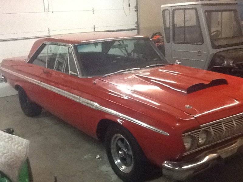

Dusty in the garage, and a poor camera in my tablet, but this is what I got. The daisies will NOT be used. The rears have too little backspace to put a decent tire on and clear the fender. I want tall fronts and short fronts , depending on if I'm redlighting at the track, or not
Thank you for posting these pics. I really like your car! Now, I have to add another car to my bucket list.
I really like the first picture with the steelies and the hubcap. What size was that tire?

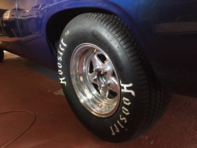

This is the look I am going for with the front tire size. I cannot tell if these are drag racing front runners, or tall and skinny street tires. Anyone know what size these may have been?
i have a '65 coronet with 15x8/4.5" backspace torque thrust and 275-60's. my comfort level ends here. the top of the outer wheelhouse can be a problem area when trying to run a near stock ride height.
Thank you!
If I remember right, they are 225/70x15s on a six inch rim. I'm a long ways away from those tires at the moment. 255/70x15 on the back, on 15x8 ramcharger steelies, for a street setup. (67 barracuda caps).
