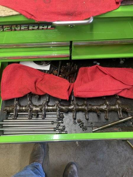

Okay so I’m in the process of. Going thru a 440 I put together probably 15-20 years ago using parts my dad had left over from a 440 the crank main caps backed out of and broke the block and junk the crank
I have a 65 440 block. And I put a new bottom end in it but the engine dad built years ago late 80s early 90s when I was a kid didn’t have many miles on it when it failed so I used things like the cam over and lifters. But he had set of adjustable rockers laying around Along with the push rods I have 2 lifters that sized. From sitting the seat is stuck that is in the lifter body and I can’t seem to get them apart
So after looking at summits web site I thought I’d buy a new set. Then I thought well maybe I’d get a new cam then I seen where the lifters at different 67 and down comp wants you to run 824’s lifters
68 and up are 822’s the lifters I have are 822’s comp offers a kit. For $388
With the cam and 824’s
My block is a 65
I’d have to double check the one dad used
My question is if I’m running the rest of the valve train out of a 68 and newer block will the 822’s lifters work in this 65 block
The difference is; the 67 down lifters were for a 5/16 ball end pushrod. 68 up 3/8
So if you're going to use the mechanical pushrods, they are likely the newer ones. Measure the lifter end of rods
Okay cool I couldn’t for the life of me figure out what the difference was

So after going and looking at the original block that ended up broken it was a 69 block either it be and early or a late. I couldn’t make out the first number
But so far from what I’m seeing is. 68 and later the they took pushrods with with 5/16 ends and the 67 and earlier ones took 1/4s or at least that’s what I’m getting
So the block dosent care if I run lifters for a 68 or newer right. I dug out the original set of rocker arms and lifters I just have to find one cause it’s missing so I’ll have to measure these ones
