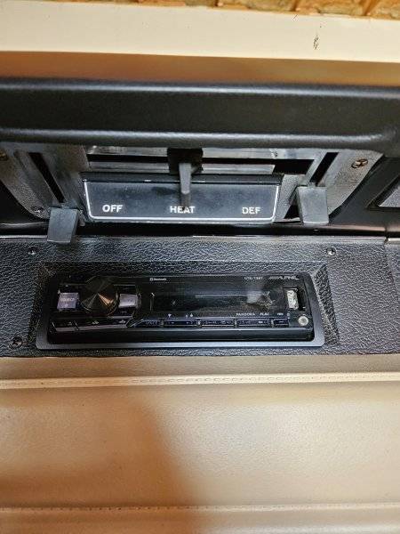

Need a little help on what the sliders control on the sides of the control panel. I've been messing with them and I don't think anything works. Not sure if the heater box is bad. Just need a little guidance on what I should be looking at to diagnose the issue.

Far left is electric fan speed, center and far right are on cables. Can remove screws on unit and see if cable poped off or slide and see with glove box out if cables opening/closing on heater box unless you can see them without removing glove box. Hope this helps. Mine has resistance telling me it’s opening/closing. Think if it was easy the cable pooped off
Hey, heater blowing? Blown fuse for blower motor?

Ok perfect. Thanks. What does the ride slider control and the left one being the fan speed is pressed all the way down faster and pull it towards me slower or vice versa?

Right should control temp amount of heat Yes left in faster out slower. Check fuse first and or ground. Maybe blower motor shot or critters in there lol. I’ve never replaced one in mine knock on would but inside the box. Switch good? Maybe gummed up. Another thing that plugs into the blower box and can be seen with out removing glove box ( think it’s green wire and black wire. Also it plugs into blower box resistor. I’ve seen those go bad but only for me when I don’t have 1 of 3 speeds

Under hood picture, is it even hooked up? Then fuses, sliders, switch, and blower resistor.
Looks like your control must have been replaced with a 69-70 style. 68 was different in appearance but probably functioned the same. Dash panel is ribbed in 68.
