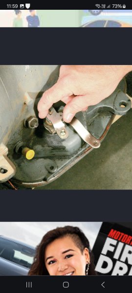

hey guys, im trying to adjust the kickdown on my 727 - these are the issues im facing-
1)shifts to second too fast - at like 1200 rpms ( 8-10mph ) - to 3rd at 2k rpms (15 -20 mph)
2) does not downshift to 2-1 at low speeds unless i come to a complete stop .
ive got a bouchillon kickdown cable and bracket . ive set the cable up at full throttle and the lever goes fully backwards under full throttle. At WOT the shifts points are fair.
my another question is does the lever needs to be fully forward at idle?( which it is now with a spring making sure it goes back too)

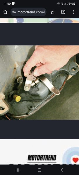

i read in the below article that it needs to be put on where you start feeling pressure?90 degrees? please find the aritcle below
https://www.motortrend.com/how-to/the-lowdown-on-stock-torqueflite-kick-down-linkage/
looking forward from hearing from you mopar gurus !!
cheers

But in the same article mentioned above it says it needs to be like this at idle ?

If u see my above post with pictures it seems that might be the reason cause if I go WOT it shifts bang on ? And the article is about when using an aftermarket cable

Yes at idle the lever should be just starting to press on the internal spring. So the 90 degree is close
