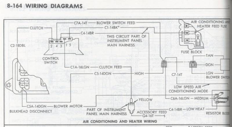

The blower for the heat and def comes directly from control switch, not from the blower speed selector. Is a single low speed AND is the brown wire coming out from the control main switch up to one of the resistors block.
Here is a 71/72 diagram. Pretty much the same to the 73/74 except for the blower speed switch, althought wiring functions and colors are the same. Just the switch itself along with the plug prongs disposition changes
If I'm correct, I should be checking terminal #3 or #4 on the control switch for voltage when heat or defog is selected? The a/c compressor has been removed from this car but I would like to at least have defog if caught in bad weather. As far as I can tell, the modes are switching in the housing as they should.
You obviously have power to 4 and power out of 3 to the blower switch as you claim all the blower speeds work on the other modes. That only leaves one possibility the master push button switch.
Per diagram posted power coming out from 4 (brown wire) on Heat and Def. Be just sure is the brown wire no matter the cavity. I can’t recall if 73/74 control switch meets EXACTLY to the 71/72 diagram, since I recall the 71/72 gets the OFF position in diff position than 73/74. So just in case, you must be sure is the BROWN wire. Can be checked at resistor block wire end.
