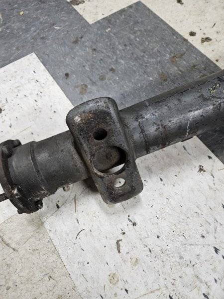

I didn't want to make a new post, so maybe someone can chime in. Just by looking at this, is this already set for the iso clamp system? The guy I got it from believed it came out of a 72, but that's an awful large central hole....insert joke.
