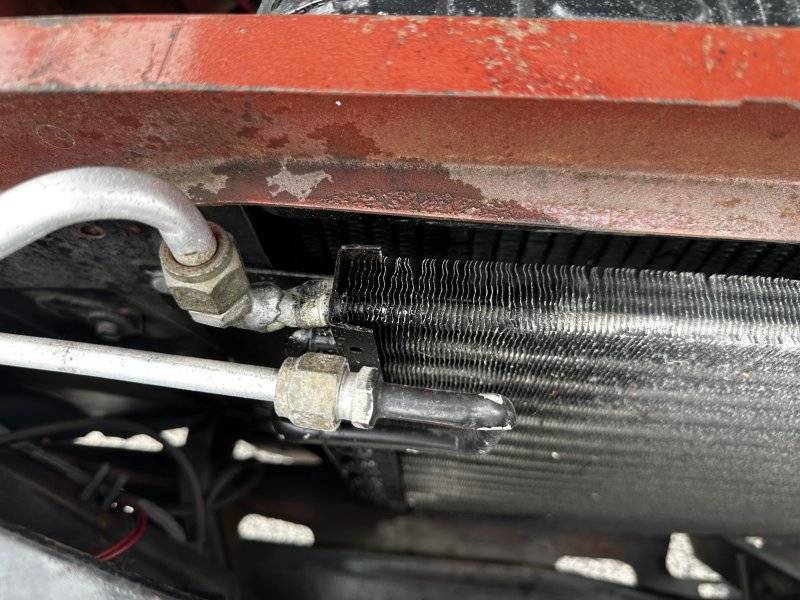

68 charger, 383, original AC car. My car had a restoration about 10 years ago, during that time all systems were restored (including AC system - all hoses are almost new). Recently the connector on the condensor failed, so im thinking about upgrading the compressor to a new sanden unit (i live in miami, and at idle-intraffic, my ac don't work too well). I see that condensors are about $200-300 and compressor is about $200 (classic industries - vintage air parts), about $500 in total. But then I also see an upgrade kit on "original air" for $1350, and it comes with a whole bunch of parts... all my hoses, connectors are newer parts, so I'm trying to see if I still need a kit or just the compresor and the condensor? below is what is listed for the conversion kit.

*in second pic u can see where the weld failed.

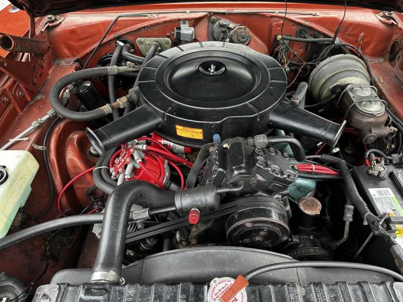

so here is whats my under hood looks like. You can see the lines on the left, including a newer style drier, newer style lines. Though as I am looking at the kit, it does appear that the lines going to compressor are routed different and have a different fitting. So can get away with getting compressor, condensor, line from compressor to condensor and charge line? I assume i would also need a bracket... but would I need Replacement Filter/Drier, Reproduction Condenser Mount Bushings (4-piece set), Replacement Expansion Valve, Thermostat?
I would replace the condenser and drier. Charge it up and check performance before replacing more parts. If fitting was compromised, refrigerant likely leaked causing your poor cooling.
it was the weld that failed on the condenser. Before this, all worked well (well, the compressor leaked a bit out of the clutch, but i refilled it once a year and all was well). I did have cooling issues at idle, and my belts would flap with AC on at idle (there is no more adjustment that can be made on the alternator and the belts are the right size/its tight when car is off). Considering i live in a very hot climate, I'd rather have uncompromized AC.

That original system under the hood looks so good. If it were mine I would replace the condenser with one as original as possible along with the dryer. If the compressor is leaking around the seal, I would address that problem too. You might as well, because I have seen 40 plus year old cars still running R12 and not leaking. As far as the belts flapping some, that's sort of hard to eliminate as they are not sold in matched pairs anymore. The old R12 systems converted to R134 still work great.
In the end, that's just my opinion, but it's your car and your call.

I agree with JH. Your car looks so good under the hood I wouldn't change it. (And I'm not a purist, I'll butcher anything.) Get some new parts, and if you haven't already, convert to 134A. JMO

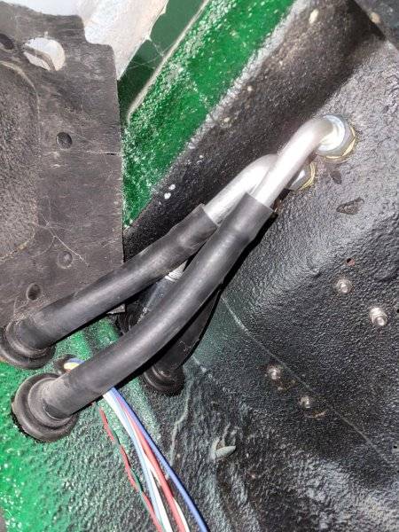

I used Vintage air, but I used a bulkhead connector further back towards the firewall. I didn't care for bringing it through the adjuster hole. I also used black nylon hose covering over the rubber hoses, I hate showing rubber hoses connected to a 10k engine. I also used Autoplumb AN hoses for the radiator. Not cheap, but that cheap metal flex hosing looks worse to me than factory style rubber hose. I went with CVF serpentine drive, so the Sanden compressor is on the passenger side.
