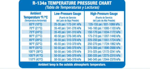

This is the chart that Randy posted in my own thread:

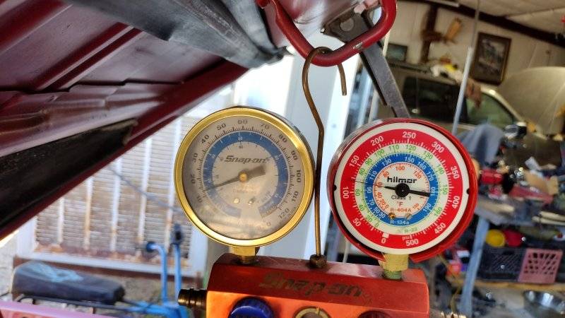

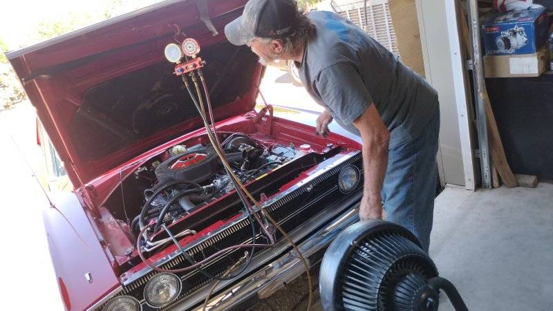

Okay for whatever reason my mechanic friend is gun shy about possibly overcharging the system. From advice I received from a few other AC guys I asked him to add a few more ounces. So we put around 6 ounces more in which is about half a can of R134. We had the fan blowing high speed on the grill and brought the idle up. Vintage Air said 12 to 20 is optimal and we seemed to do well at 15.
The center vents are around 44F and the outer vents are 47F. This is about 10 degrees lower than I had on Friday. Time will tell.

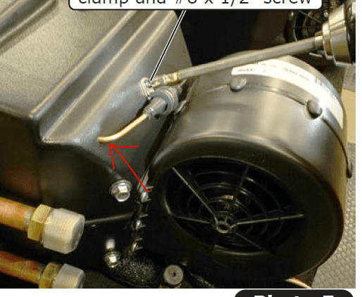

Reply from Vintage Air
Bill,
44°F is great, this will provide a very comfortable cabin when in the heat of the summer.
Let me provide one small trick to squeeze a few more degrees
Directly below the blower motor you will see a small copper tube that goes into the evap. case. Grab the copper tube where it enters the case and pull the tube out by apx 3/8”- ½”
What this does is trick the probe to read a slightly higher temp and ask the compressor to cycle for just a bit longer than before. This often times will drop the temp a few degrees.
thumbnail
The picture is the unit upside down, the tube to look for would be below the blower motor housing.
Photo from vintage air

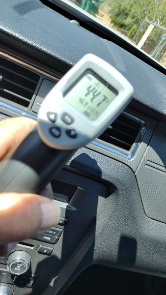

Maybe apples and oranges, but drove my 2012 mustang today and realized it has one of the best AC systems of all of my cars; at least it feels that way. Small cabin area helps I guess.
Anyhow I had to check it's AC temps. Thermometer on the back porch was showing 86F. Max AC and fan at mid range. I measured 44.7F three times in a row. So, for now I'm good with the coronet blowing 44F.
