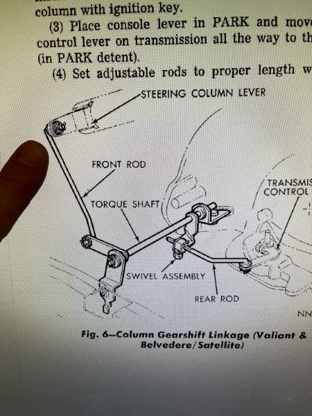

So I seem to be missing my hardware bag that connects my front transmission rod to the steering column. The steering column flange hole is much larger than the pined rod. So there must be some bushing that I am missing.
Can anyone help me identify what parts I am missing to join the rid to the steering flange and where I might get what I need?

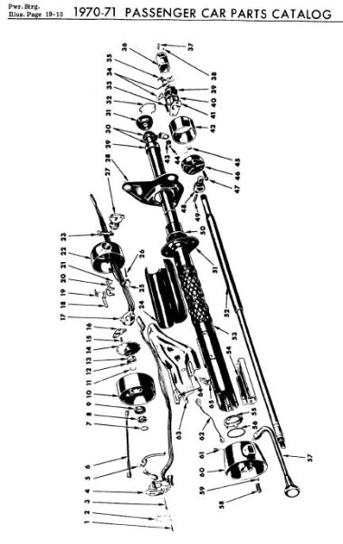

There would be a flanged rubber bushing that fits into the lever. Then a brass bushing on the rod. There also was a large spring washer or thin flat washer I think and the clip.

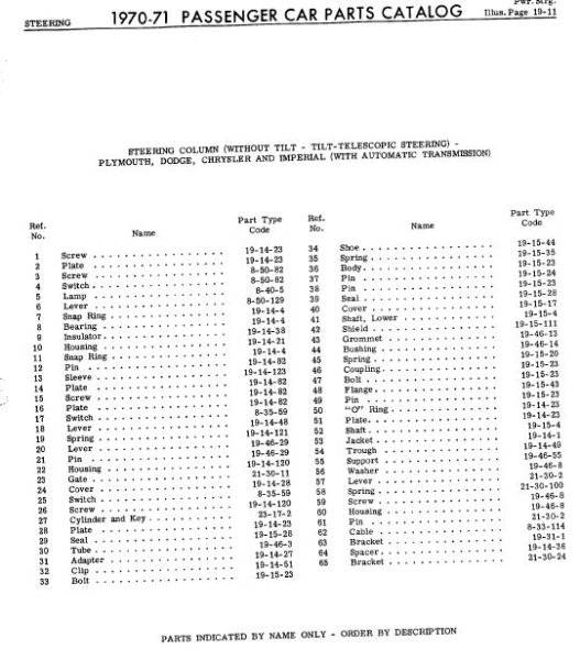

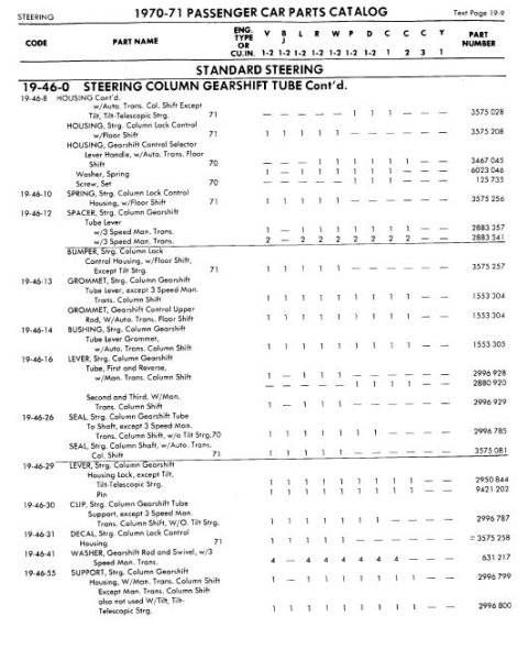

Thanks you guys are right and know what I’m needing. It looks like,#43 & #44 what I need, now how do I further identify and moreover obtain these?
FNA man you’re awesome! Thanks so much! Looks like this and the cotter pin might be all I need!
Thanks again!
