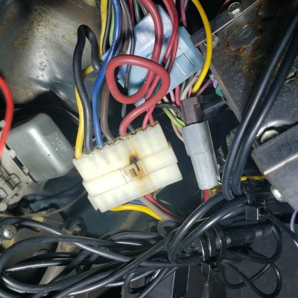

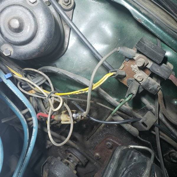

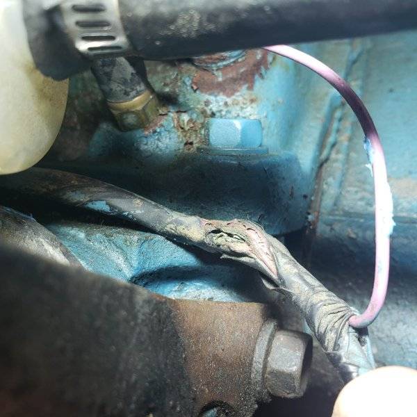

Run a HD temporary jumper direct from the alternator stud to the battery and then see what the alternator does. If you full field it and it is still low I suspect alternator problems.
Just went thru this on a buddy's 74 model, this is what we found:
