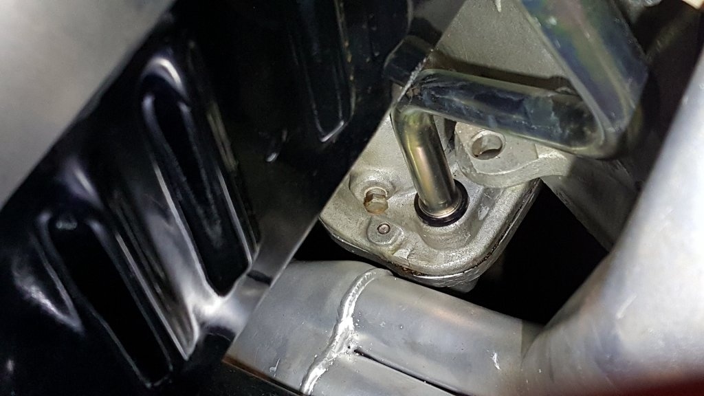

Had the same problem ordered a Hughes Performance 727 locking stick for big blocks part # HP1235A it has a rubber sleeve that goes into the tube hole first with a stop on top. Them install tube this does a great job to seal up the dipstick hole.
View attachment 390861 Had the same problem ordered a Hughes Performance 727 locking stick for big blocks part # HP1235A it has a rubber sleeve that goes into the tube hole first with a stop on top. Them install tube this does a great job to seal up the dipstick hole.
