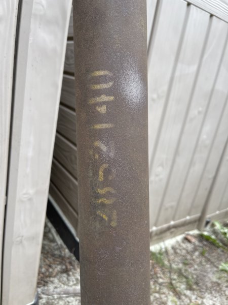

Trying to identify a belvedere driveshaft part#2852140 if anyone has a parts book help!!!
P/N looks like a 68. You could download a 68 parts book @mymopar.com. Parts books are hard to use a computer, MO. It's flipping pages and if your not familiar with parts book its harder.
No listing for a 70 Belvedere 4-speed Dana. ??? 68-69, then 71
Same part number on my 67 GTX’s
