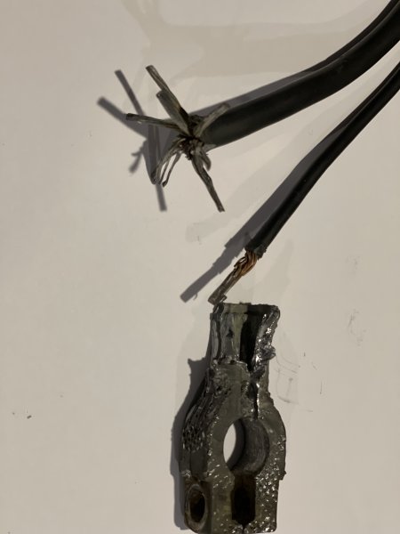

What would cause my front light wiring to melt in a matter of seconds? Right down to bare wires for about 2 feet from the headlight and also the side marker light? Key was in the on position. Car would not start in the start position only making a buz at the starter relay. I removed the front harness and bought a new one, b ut do not think I should install the new one until I sort this out? How do I proceed to test this issue?

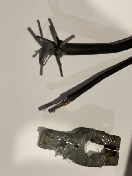

My bet is on a bad negative battery cable, high resistance in one of the ends/terminations. Do a voltage drop test between the engine block and the negative battery post while attempting to crank. Leave the ignition switch off, jump the starter relay for testing. Nothing in the forward lighting harness related to key-on with any kind of current potential that could burn wires. Has to be the lighting ground wires in the harness trying to provide a return path from the starter to the battery. Too, get some jumper cables and jump the negative battery post to the engine block as a test.

You need to measure the resistance through your ground cables, you can't just assume they are good because they look it. I have had a brand new battery cable that was junk because of a bad factory crimp. Looked fine, but it wasn't.....
Like stated above, my money is on a bad main ground cable. The starter is trying to pull its ground from somewhere else, but no other wires in the car are big enough for that current draw.
Once nice thing about '69 and back, in stock form... that can't happen. 70 and up has the extra small ground wire from battery to body and you bet your *** that starter will fry everything in it's path looking for ground if you have a bad main cable to the engine.

I’ve heard there have been many problems with the more recent cheap reproductions of the original 2983778 (’70 and up) negative cable, poor crimps, high resistance. Never had a problem an OE version of that cable. While verifying the part number, found notes from 2009 where I paid a local dealer $14 for that original replacement cable, still available through Chrysler parts then. I see NOS 2983778 cables now at $160 and up.
