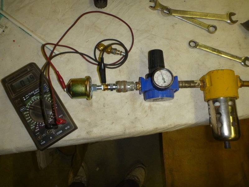

I threw my first one away and pressure tested my second one to insure it had the correct ohm range before I installed it.
The higher the pressure the lower the resistance. I forget the true numbers, but here's 75psi =19 ohms. As you lower the pressure the ohm reading should rise.

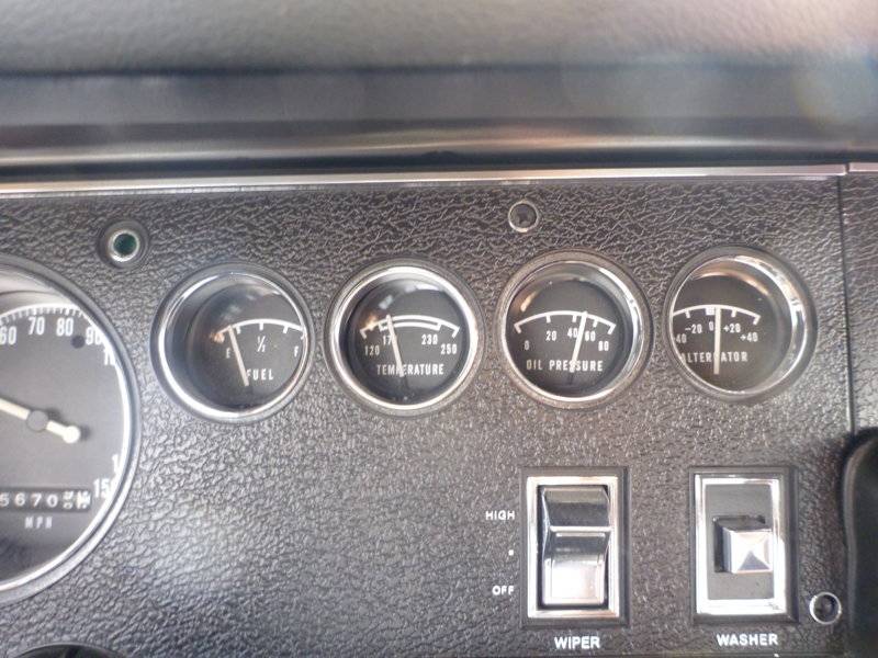

My 68 Charger is the same way.....aftermarket gauge says 25-30 at idle and 45-50 at cruise. The factory gauge says 25ish all the time. It is the right sender for the gauge type and it doesn't bother me. I just like the fact that it works and moves. I just use the old autometer gauge for accuracy. 7K worth of parts in the stroker, I have trust issues.....Haha.

Take the wire off the sender and put a 10 ohm resistor between the sender wire and a good ground, your gauge should read right at max pressure / 80psi (like Full on the fuel gauge). If it doesn't you have a sender wire with added resistance from corrosion or such.... or a gauge issue. If it does read "full" then you indeed have a crap sending unit.
My sender / gauge reads exactly what a mechanical gauge reads.
